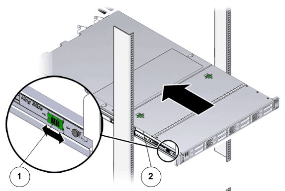

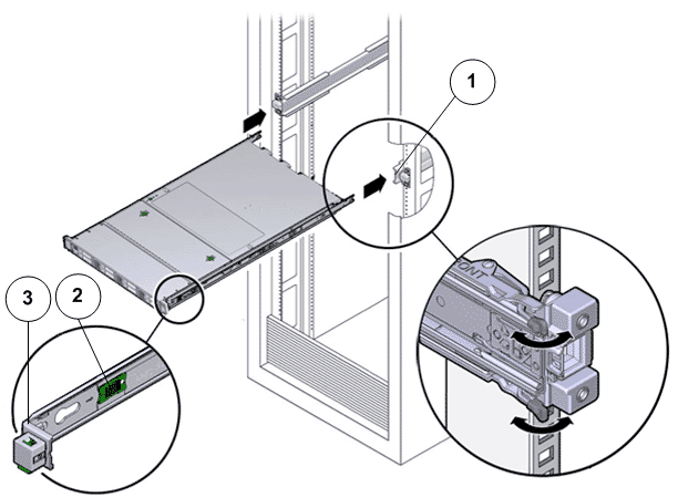

Work with a partner or use a mechanical lift for assistance. The
Pilot weighs approximately
39.9 lbs (18.1 kg). Two people are required to carry the
chassis.
Caution
Deploy any rack anti-tilt mechanisms before installing the
Pilot into the rack to prevent the rack from tipping over during component installation.
Caution
Always load equipment into a rack from the bottom up so that the rack will not become top-heavy and tip over.
Caution
Slide rail mounted components are not to be used as a shelf or a work space.
