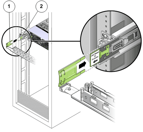

- At the back of the rack, plug the CMA rail extension into the end of the left slide rail assembly.
Figure 1 CMA rail extension inserted into the back of the left slide rail - Legend
1 CMA rail extension |
2 Slide rail |

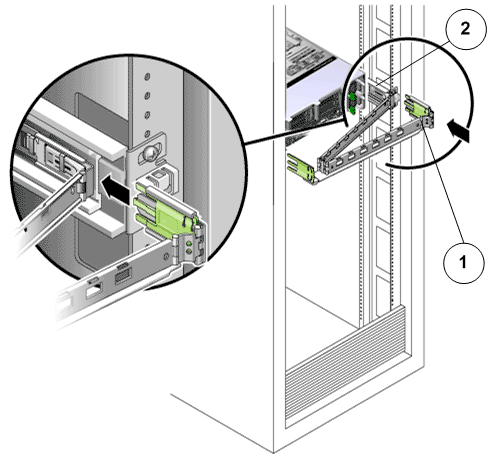

- Insert the smaller extension into the clip located at the end of the mounting bracket.
Figure 2 Inner CMA connector mounted - Legend
1 Slide rail |
2 Inner CMA connector |
3 Clip |

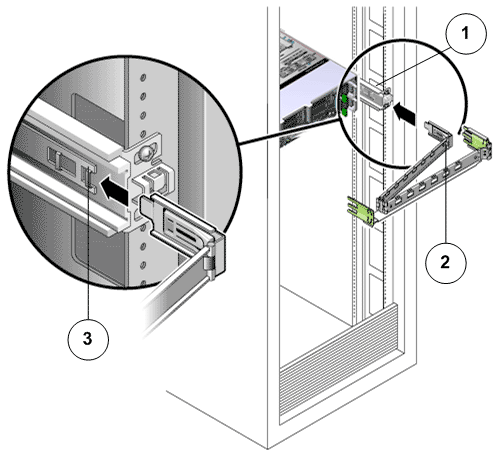

- Insert the outer CMA connector into the end of the right sliding rail.
Figure 3 Outer CMA connector attached - Legend
1 Outer CMA connector |
2 Slide rail |

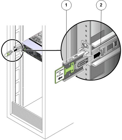

- Fully insert the hinged plastic connector at the left side of the CMA into the CMA rail extension.
Figure 4 Left side of the slide rail mounted - Legend
1 Plastic tab on CMA rail extension |
2 Slide rail |
