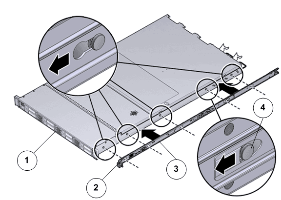

Install the slide rails with mounting brackets on to the Pilot chassis before inserting it into the rack.
- Position a mounting bracket against the Pilot chassis so that the slide rail lock is at the Pilot front, and the five keyhole openings on the mounting bracket are aligned with the five locating pins on the side of the Pilot chassis.
Figure 1 Mounting bracket aligned with the Pilot chassis
- Legend
| 1 Pilot chassis front |
| 2 Slide rail lock |
| 3 Mounting bracket |
| 4 Mounting bracket clip |
- With the heads of the five chassis locating pins protruding though the five keyhole openings in the mounting bracket, pull the mounting bracket toward the front of the Pilot chassis until the mounting bracket clip locks into place with an audible click.
- Verify that the rear locating pin has engaged the mounting bracket clip.
- Repeat steps to install the remaining slide rail mounting bracket on the other side of the Pilot chassis.
