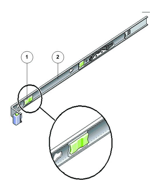

  1. Unlock the slide lock buttons at the right and left sides of the Controller chassis, and slowly pull the Controller out of the rack until the slide rails reach their stops.
    Figure 1 Controller slide rails unlocked Controller slide rails unlocked
    Legend
    1 Slide rail assembly
    2 Slide rail lock button

  6. Simultaneously unlock both slide rail release buttons, and push the Controller completely into the rack.
    Figure 3 Slide rail release button Slide rail release button
    Legend
    1 Slide rail release button
    2 Slide rail
    Note: The Controller should stop after approximately 15 inches (40 cm) of travel.
