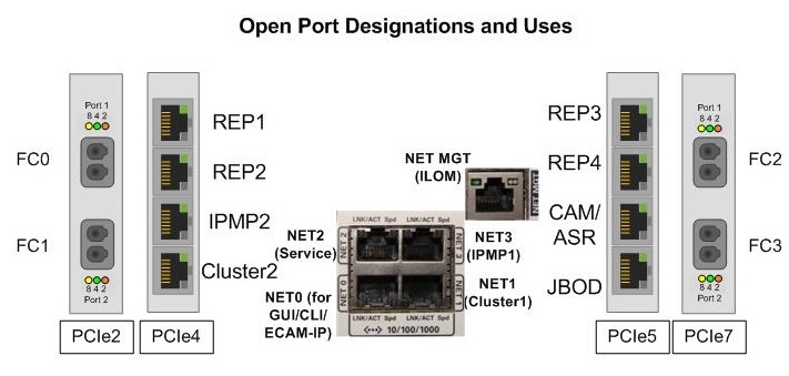

VSM 6 Ethernet (IP) Port Assignments
As shown in Figure 6-1, there are 12 Ethernet ports on each VSM 6 node. These port assignments assume Solaris 11.1 or higher is installed on the VSM 6 server nodes.
Figure 6-1 VSM 6 Ethernet Ports
Surrounding text describes Figure 6-1 .
  • Port 0 (NET0) is for user interface connections (CLI, GUI, ECAM over IP).
  • Port 1 (NET1), port 3 (NET3), port 6 (IPM2), and port 7 (Cluster2) are connected between nodes for cluster support.
  • Port 2 (NET2) is a dedicated maintenance port reserved for direct connection by Services personnel.
  • Ports 4, 5, 8, and 9 (REP1, REP2, REP3,and REP4) are available for connection to the customer-defined network for IP replication use.
  • Port 10 (ASR) is available for Outbound ASR.
  • Port 11 (JBOD) connects the server(s) to the first disk shelf above them in the stack.

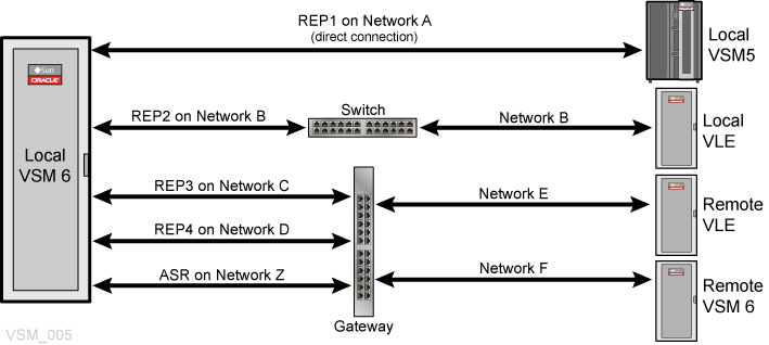

Network Port Scenarios
Common network port scenarios include:
  • Scenario 1: Connect the VSM 5 IFF port and a VSM 6 replication port in the data center.
    Direct connections are made point-to-point with a network cable between interfaces, and the interface connections are on the same network. Only one connection is possible in this scenario. No gateway is required. Static routing is not required.
  • Scenario 2: Connect a VSM 5 IFF port and a VLE port to a VSM 6 replication port in the data center.
    Connections are between interfaces through a switch, and the interface connections are on the same network. From one to many connections are possible. No gateway is required. Static routing is not required.
  • Scenario 3: Connect a VSM 6 replication port to a VSM 6 replication port in a remote data center, or set up ASR connection to a remote support site.
    Connections between interfaces are through a gateway, and the interface connections are on different networks. From one to many connections are possible. A gateway is required. Static routing may be required if the customer cannot segregate and there is more than one route to the target.
A VSM 6 node is configurable in an environment such that one, two, or all three scenarios are implemented.
Node Configuration Example
The example node configuration shown in Figure 6-2 covers all three scenarios:
  • The first replication port (network A) is connected directly to a local VSM 5 IFF port.
  • The second replication port (network B) is connected to a local VLE port through a switch.
  • The third replication port (network C) targets a remote VLE port on a different network.
  • The fourth replication port (network D) targets replication ports on a remote VSM 6 port on a different network.
  • ASR traffic (network Z) is sent to Oracle.

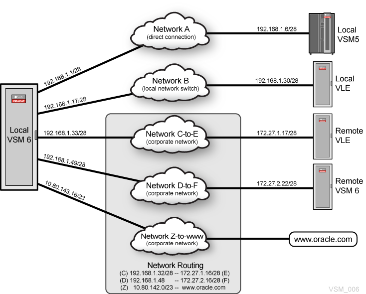

Direct, Switched, and Gateway Configuration Scenarios
Figure 6-3 shows a network with a direct connection, a network with a switch connection, and three networks with connections through a gateway.
Figure 6-3 Example Direct, Switched, and Gateway Connection Scenarios
Surrounding text describes Figure 6-3 .

Table 6-6 shows a sample layout between local VSM 6 ports and various target network ports using IP addresses provided by the customer.
Table 6-6 Sample Layout for VSM 6 Node 1 Ports and Target Network Ports
Port (Node 1) IP Address Scenario Gateway Target Port Target Address
VSM6-REP1
192.168.1.1/28
1 (Net A)
N/A
Local-VSM5
192.168.1.6/28
VSM6-REP2
192.168.1.17/28
2 (Net B)
N/A
Local-VLE
192.168.1.30/28
VSM6-REP3
192.168.1.33/28
3 (Net C)
192.168.1.46
Remote-VLE
172.27.1.17/28
VSM6-REP4
192.168.1.49/28
3 (Net D)
192.168.1.62
Remote-VSM 6
172.27.2.22/28
VSM6-ASR
10.80.143.16/23
3 (Net Z)
10.80.143.254
Oracle-Support
Oracle-Support
Table 6-7 shows Node 2 with ports on the same subnets as those on Node 1.
If traffic to the remote-VLE and the remote-VSM can route from both VSM6-REP3 or VSM6-Rep4, then static routing may be necessary. Consequently, a gateway is required.
Table 6-7 Sample Layout for VSM 6 Node 2 Ports and Target Network Ports
Port (Node 2) IP Address Scenario Gateway Target Port Target Address
VSM6-REP1
192.168.1.2/28
1 (Net A)
N/A
Local-VSM5
192.168.1.7/28
VSM6-REP2
192.168.1.18/28
2 (Net B)
N/A
Local-VLE
192.168.1.30/28
VSM6-REP3
192.168.1.34/28
3 (Net C)
192.168.1.46
Remote-VLE
172.27.1.17/28
VSM6-REP4
192.168.1.50/28
3 (Net D)
192.168.1.62
Remote-VSM 6
172.27.2.22/28
VSM6-ASR
10.80.143.17/23
3 (Net Z)
10.80.143.254
Oracle-Support
Oracle-Support

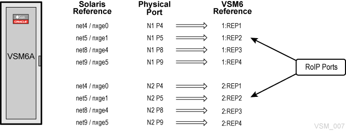

VSM 6 IP Replication: Define the Replication Ports
  • Each port defined as an RoIP is just a route out from the VSM 6.
  • The number of RoIP routes defined does not relate to the IPPATHs defined for the vRTD/CLINKs.
  • Multiple RoIP ports provide bandwidth and resilience.
Figure 6-4 VSM 6 IP Replication – Define the Replication Ports
Surrounding text describes Figure 6-4 .
VSM 6 CLI Example:
vsmadmin: update ipport –name 1:REP1 –ip 35.107.24.1/24
vsmadmin: update ipport –name 2:REP2 –ip 35.107.25.2/24

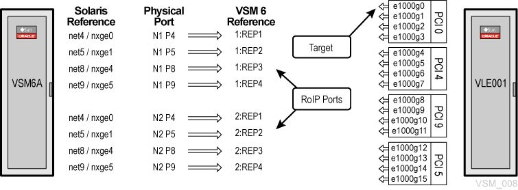

VSM 6 VLE Connectivity: Define the IPPATH
  • VTCS uses the VLE name of the target defined on the IPPATH command used in the VSM 6 CLI. Each IPPATH is just a route out of the VSM 6 to the VSM target.
  • vRTDs are defined to VTCS as IP devices with IPIF ids.
  • The IPIF id is not used to reference the definition but must be present to meet VTCS syntax rules. Each IPIF id must be unique and with valid syntax for each VSM 6 defined in VTCS.
  • VTCS allows 16 IPIF ids total, so each VSM 6 can have a maximum combined total of 16 IP vRTDs/CLINKS in any combination.
Figure 6-5 VSM 6 VLE Connectivity – Define the IPPATH
Surrounding text describes Figure 6-5 .
VSM 6 CLI Example:
vsmadmin: add ippath –target vle -name V6VRTD00 –ip 35.107.22.10
VTCS Example:
RTD NAME=V6VRTD00 STORMNGR=VLE001 IPIF=0A:0

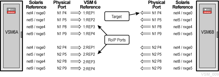

VSM 6 CLINK Connectivity: Define the IPPATH
  • VTCS and VSM 6 use the VSM partner on the CLINK definitions and the VTSS target name on the IPPATH command to link the CLINKs. Each IPPATH is just a route out of the VSM 6 to the VSM target.
  • VTCS sees all VSM 6 CLINKs as IP devices.
  • CLINKs are defined to VTCS as IP devices with IPIF ids.
  • The IPIF id is not used to reference the definition but must be present to meet VTCS syntax rules. Each IPIF id must be unique for each VSM 6 defined in VTCS.
  • VTCS can have multiple CLINKs defined even for a single IPPATH. Best practice is to define as many CLINKs to VTCS as possible.
Figure 6-6 VSM 6 CLINK Connectivity – Define the IPPATH
Surrounding text describes Figure 6-6 .
VSM 6 CLI Example:
vsmadmin: add ippath –target vtss -name VSM6B –ip 35.107.23.10
VTCS Example:
CLINK IPIF=0A:2 PARTNER=VSM6B
CLINK IPIF=0I:0 PARTNER=VSM6B
