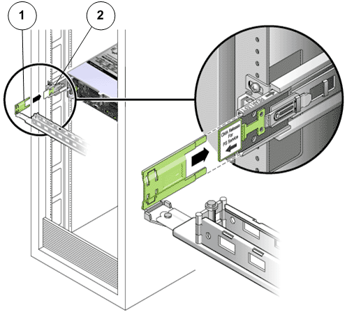

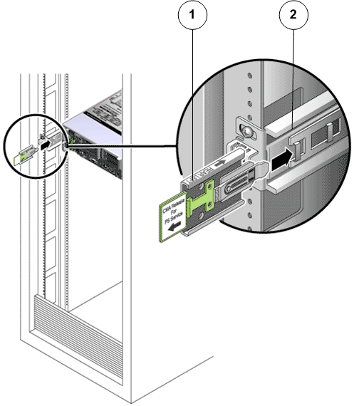

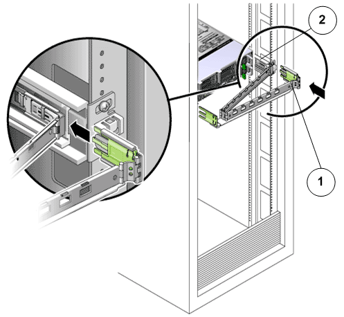

The cable management arm (CMA) clips into the ends of the left and right Replication Engine slide rail assemblies. No screws are necessary for mounting the CMA. The right sides of the two CMA arms have hinged extensions. On the manufacturer's instruction sheet, the smaller extension is called the CMA Connector for Inner Member. It attaches to the right mounting bracket. The larger extension is called the CMA Connector for Outer Member, and attaches to the right sliding rail.
Figure 1: CMA rail extension inserted into the back of the left slide rail
| 1 CMA rail extension | 2 Slide rail |
Figure 2: Inner CMA connector mounted
| 1 Slide rail | 2 Inner CMA connector |
| 3 Clip |
Figure 3: Outer CMA connector attached
| 1 Outer CMA connector | 2 Slide rail |

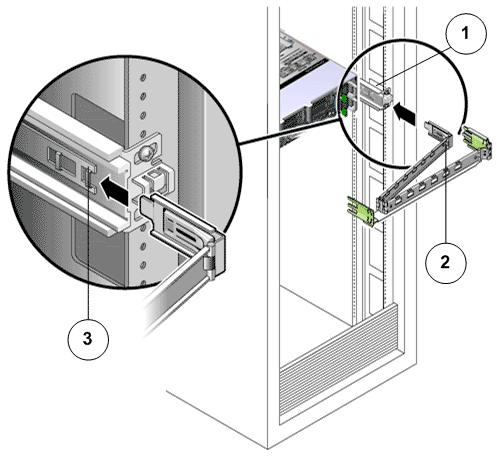

Figure 4: Left side of the slide rail mounted
| 1 Plastic tab on CMA rail extension | 2 Slide rail |
