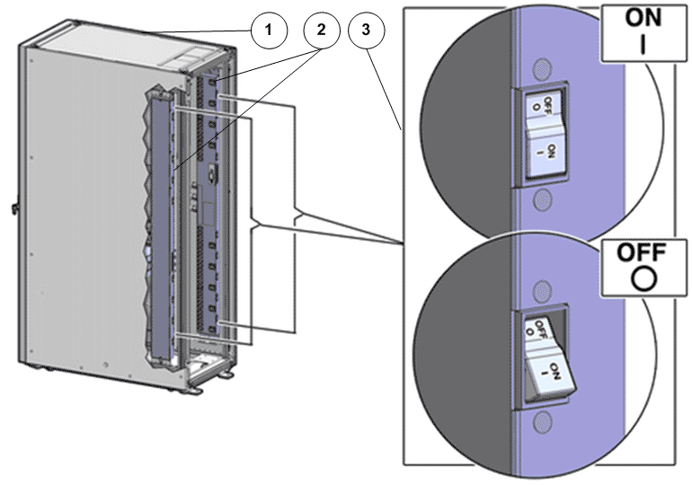

  1. Power on the PDU circuit breakers to apply power to the Replication Engine.
    Figure 1: PDU circuit breakers
    Legend
    1 Oracle rack 2 PDU circuit breakers
    3 Toggle switch
    Note: The PDU circuit breakers are at the back of the rack. Press down on the ON (1) toggle switch.
    Note: The example illustrates the process for powering on the PDU for rack mounted systems. The process for powering on the PDU might vary for rack-ready systems.

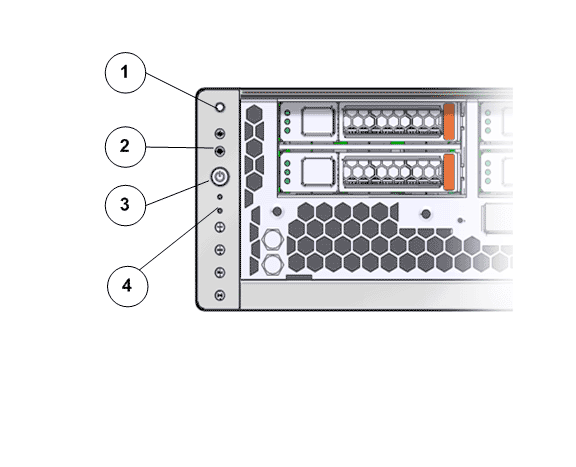

  2. If the Replication Engine does not power on automatically, use the power switch on the front panel of the Replication Engine to power on.
  3. Check the Power or OK LED on the front panel of the Replication Engine for activity.
    Figure 2: Replication Engine front panel LEDs
    Legend
    1 Chassis identification LED or Locator LED 2 Motherboard or Power or OK LED
    3 Power switch 4 Back power supply LED
    The LEDs turns green when the Replication Engine is powered on.
  4. Check the back power supply LEDs that is located on the front panel and indicate the state of the power supplies.
  5. Contact Oracle Customer Support if the power LED or OK LED on the Replication Engine front panel is not green.
    The power LED or OK LED not being green indicates that there is no hard drive activity.
