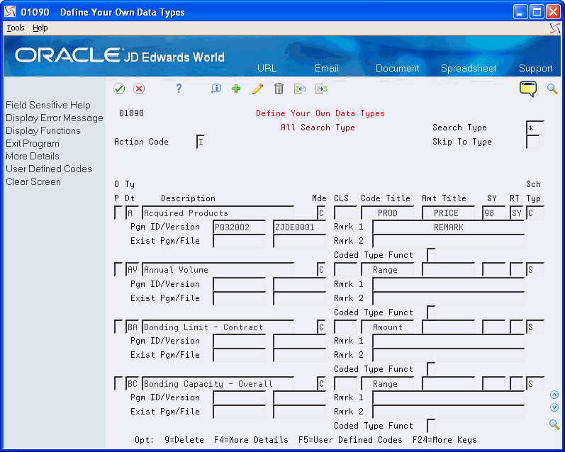

Figure 28-1 Define Your Own Data Types screen
Complete the following fields:
Type Data
Mode (Mde)
Complete the following optional fields:
Description
Class (CLS)
Code Title
Amount Title
System (SY)
Record Type (RT)
Search Type
Access the detail area (F4).

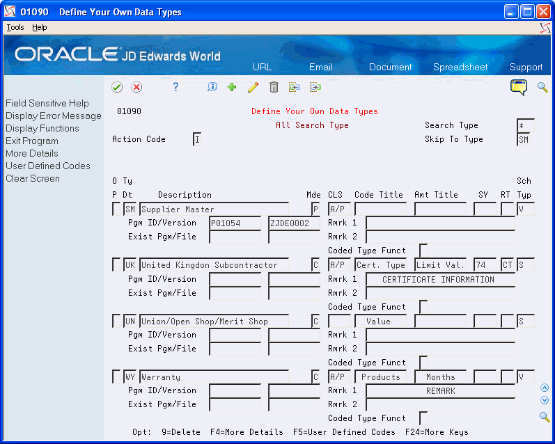

Figure 28-2 Define Your Own Data Types (Details) screen
Remark 1
Remark 2
Coded Type Function
Press Enter
Field | Explanation |
Type Data | A code that identifies a specific type of data within a classification. |
Mde | The format of a data type. This code determines the display mode for supplemental data. Valid codes are:
C – Code format, which displays the form for entering code-specific information. These codes are associated with User-Defined Codes table (F0005). N – Narrative format, which displays the form for entering narrative text. P – Program exit, which allows you to exit to the program you specified in the Pgm ID field. M – Message format, which displays the form for entering code-specific information. However, the system can edit the code values you enter against values in the Generic Rates and Messages file (F00191). This code is not used by the Human Resources or Financials systems. |
Description | A user-defined name or remark. |
CLS | A user-defined code that identifies a group of data types in the Central Information File. |
Code Title | The heading for a column on Supplemental Data Entry that relates to user-defined codes. Enter the user-defined codes for the supplemental data type in this column. For example, if the supplemental data type relates to the educational degrees of employees (BA, MBA, PHD, and so on), the heading could be Degree. |
Amt Title | The heading for a column on Supplemental Data Entry that relates to an amount. This column contains statistical or measurable information. For example, if the data type relates to bid submittals, the heading could be Bid Amounts. |
SY | A user-defined code (98/SY) that identifies a JD Edwards World system. |
RT | Identifies the file that contains user-defined codes. The file is also referred to as a code type.
Form-specific information This code identifies the record (code) type, such as BS for bid submittals, DT for document type, MC for business unit type, PY for payment instrument, and so on. |
Search Type | A user-defined code (01/ST) that identifies the kind of address book record you want the system to select when you search for a name or message. For example:
E – Employees X – Ex-employees V – Suppliers C – Customers P – Prospects M – Mail distribution lists |
Rmrk 1 | The heading for a column on Supplemental Data Entry that relates to user-defined codes. This heading describes the first Remark field on the data entry form. It contains additional information and remarks. For example, if the data type relates to bid submittals, the heading could be Subcontractor. |
Rmrk 2 | The heading for a column on Supplemental Data Entry that relates to user-defined codes. This heading describes the second Remark field on the data entry form. It contains additional information and remarks. For example, if the data type relates to the educational degrees of employees, the heading could be College or University. |
Coded Type Function | This field applies to data types that are designated as Coded types (have a C in the Display Mode field). The value you enter determines which information (valid code value or amount value) will appear on the Communications form (P010921).
If a code value is expected to be entered for this data type, enter a blank or 0 in this field. If a statistical or measurable amount will be entered with no code value, then you enter 1 in this field. If both a coded value and an amount will be entered, leave this field blank. |
Figure 28-3 Define Your Own Data Types (Program Data) screen
Program ID
Version
Existing Program
File
Press Enter.

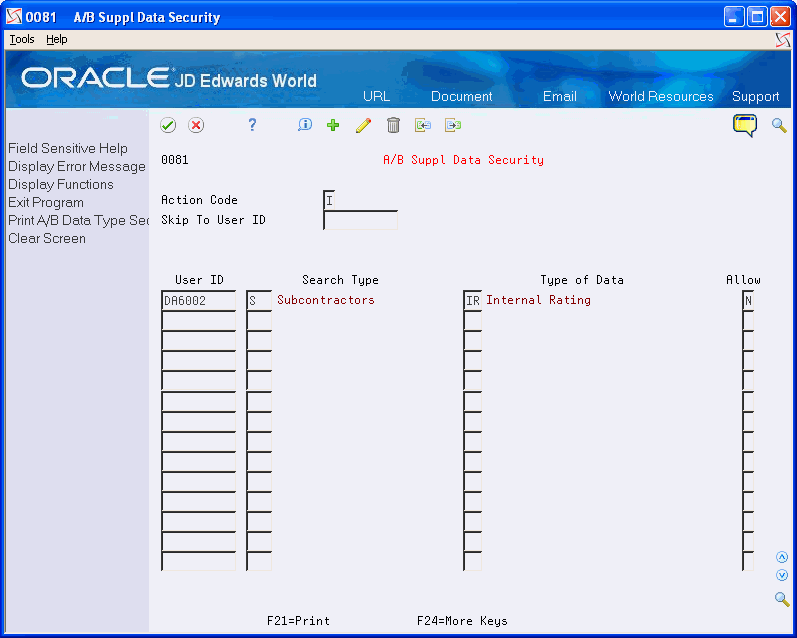

You can restrict access to certain data types. For example, you might not want your accounts payable personnel to view customer master information. Even though the A/P search type is assigned to their user profile, you can still restrict their access to this information by defining supplemental data security.
To define supplemental data security
On A/B Supplemental Data Security
Figure 28-5 A/B Supplemental Data Security screen
Complete the following field:
Skip to User ID
User ID
Search Type
Type of Data
Allow
Press Enter.
Allow | A code that indicates whether a user is allowed access to the function key or selection. Valid codes are:
Y – Yes, allow access N – No, prevent access blank Yes, allow access (default). |
