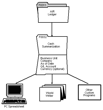

When you run A/R cash forecasting, the system:
Consolidates open invoices from the A/R Ledger table (F0311)
Summarizes information by business unit, company, due date, and currency
Deletes existing records in the Cash Summarization table (F0032) with the cash type you specify in a processing option
Updates the Cash Summarization table with the new information
The following graphic illustrates the cash forecasting process.

When you run A/R Cash Forecasting, the system creates the Cash Summarization table (F0032) that contains the following:
Total of all open invoices
Due dates of open invoices
Receipt amount required from customer

| Topic | Description |
| Viewing the results of A/R cash forecasting | You can use World Writer to view the information created when you run A/R Cash Forecasting. The information can also be downloaded to a standard spreadsheet program or used by custom programs for cash analysis. |
