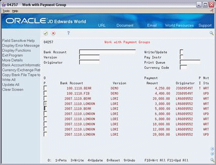

22.3 Work with Payment Groups (P04257)
When processing payment in foreign currency, you can choose to enter a spot rate to allow the exchange rate to be selected from the exchange rate table based on the payment (G/L) used. A processing option in Work with Payment groups controls this option.
To work with payment groups
On Work with Payment Groups
Figure 22-1 Work With Payment Group screen
Description of Figure 22-1 follows
Description of "Figure 22-1 Work With Payment Group screen"
  1. Complete the following field:
    • Bank Account
  2. Press Enter.
  3. Do one of the following to display the "Write Payments" screen:
    • Enter 3 in the Option (OP) field.
    • Press F10
