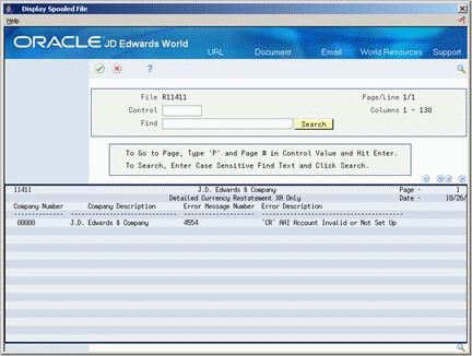

If the Detailed Currency Restatement program finds an error condition for a company before any processing takes place for the company, it stops processing eligible records, produces an error report, and does not update the XA ledger. This report indicates the type of problem. You must resolve the problem and run the program again.

| CR AAI Account Invalid or Not Set Up | The account number for the AAI item CR is not in the chart of accounts for the company. |
