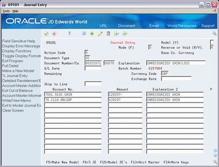

The following shows a journal entry for the sample report. The program generates this journal entry if you set the related processing options.
