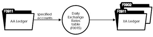

For every transaction in the domestic currency within the range or ranges of accounts specified in the AAI setup, the system creates a corresponding transaction in the alternate (stable) currency.

The following illustrates the alternate ledgers used in detailed currency restatement:
Figure 34-5 Alternate Ledgers Used in Detailed Currency Restatement
