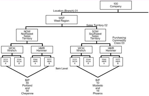

7.1.1 Example: Distribution Hierarchy for Company 100
The following chart shows an example of a distribution hierarchy for the West Region of Company 100. The East Region section of the chart would extend to the right.
Figure 7-1 Example Distribution Hierarchy for Company 100's West Region
Description of Figure 7-1 follows
Description of "Figure 7-1 Example Distribution Hierarchy for Company 100's West Region"
In this example, you define the hierarchy for the West Region as follows:
  1. Set up a West Region summary code WST.
You assign levels to in the Summary Constants table for summary code WST as follows:
  1. Assign 01 to Location or Branch.
  2. Assign 02 to Sales Territory.
  3. Assign 03 to Purchase Commodity Class.
  4. Include the item in the hierarchy that will be the last level.

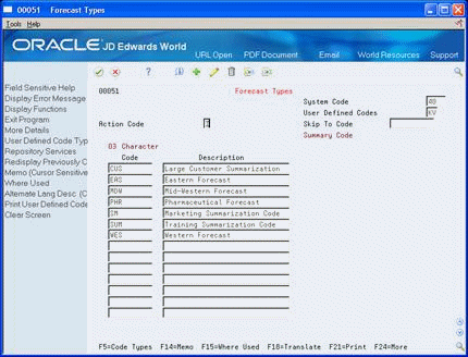

You use the summary codes entered in the Character Code fields to define the summary hierarchy when you set up summary constants.
On Summary Codes
Figure 7-2 Forecast Types (Character Codes) screen
Description of Figure 7-2 follows
Description of "Figure 7-2 Forecast Types (Character Codes) screen"
Complete the following fields:
  • Character Code - Summary Code
  • Description
Field Explanation
Character Code This column contains a list of valid codes for a specific user defined code list. The number of characters that a code can contain appears in the column title.
Description A user defined name or remark.

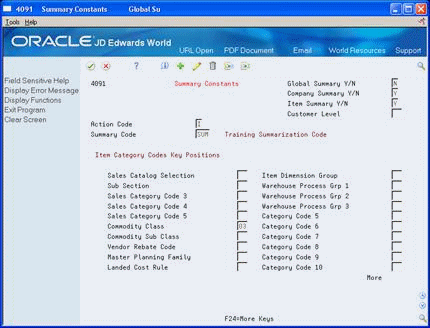

To assign summary constants
On Summary Constants
Figure 7-3 Summary Constants screen
Description of Figure 7-3 follows
Description of "Figure 7-3 Summary Constants screen"
  1. To display the sample summary constants, enter SUM in the following field:
    • Summary Code
  2. Complete the following field (for your own code):
    • Summary Code
  3. Complete the following fields:
    • Global Summary Y/N
    • Company Summary Y/N
    • Item Summary Y/N
    • Customer Level
  4. To specify the hierarchy levels, complete Category Code fields.
    Use the scroll keys to display and enter additional summary constants.
Figure 7-4 Summary Constants (Global Sum) screen
Description of Figure 7-4 follows
Description of "Figure 7-4 Summary Constants (Global Sum) screen"
Field Explanation
Summary Code The key to distinguish between different forecasting hierarchies.
Global Summary Y/N This flag indicates whether the forecast should be summarized to the global level. This level is the top level of the forecasting hierarchy and represents a summarization of all levels.
Company Summary Y/N This flag indicates whether the forecast should be summarized to the Company level. This level is the next level above the level indicated as number one in the hierarchy. All forecasts within the company will be summarized into this level.
Item Summary Y/N This flag indicates whether the forecast should be summarized down to the item number level. This level is the last level in the hierarchy. All forecast detail records for an item will be summarized into this level.
Customer Level To use Customer Number as one of the levels in the forecasting hierarchy, enter that level number here.
Item Category Codes Key Positions An indicator that specifies which level in the forecasting hierarchy a specific Category Code should be.

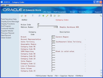

To enter category codes
On Address Book Revisions
  1. Choose Category Codes.
    Figure 7-5 Category Codes screen
    Description of Figure 7-5 follows
    Description of "Figure 7-5 Category Codes screen"
  2. On Category Codes, complete the following fields:
    • Address Number
    • Category Codes
    The following field contains default information:
    • Alpha Name
Field Explanation
Address Number A number that identifies an entry in the Address Book system. Use this number to identify employees, applicants, participants, customers, suppliers, tenants, and any other Address Book members.
Form-specific information
If you leave this field blank, the system assigns a number using the Next Numbers program.
Alpha Name The text that names or describes an address. This 40-character alphabetic field appears on a number of forms and reports. You can enter dashes, commas, and other special characters, but the system cannot search on them when you use this field to search for a name.

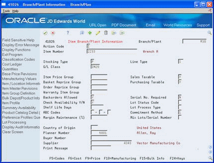

Information for an item at a specific branch is maintained in item branch records. The system stores this information in the Item Branch table (F4102). You should review the item branch records to verify that the items in each of your branches or plants contain data for the category codes you selected as levels on the Summary Constants form.
For example, you select Commodity Class as part of the hierarchy for summary code SUM. To include Wrench A (item 2233) in summary code SUM, you must verify that the value WCH appears in the Item Branch/Plant Information record for item 2233 as the category code for Commodity Class.
To review item branch records
On Item Branch/Plant Information
Figure 7-7 Branch/Plant Information screen
Description of Figure 7-7 follows
Description of "Figure 7-7 Branch/Plant Information screen"
  1. Complete the following field:
    • Item Number
  2. Choose Codes.
