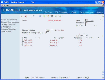

From Periodic Forecasting Operations (G3421), choose Review Forecast
You can display information by planner, master planning family, or both. You can then change the forecast type to compare different forecasts to the actual demand. You can also:
Display the data in summary or detail mode. The Detail mode lists all item numbers. The Summary mode consolidates data by master planning family.
Display all information stored in the Detail Forecast table.
Choose between quantities and amounts to review.
Complete the following fields:
Year
Forecast Type
Branch/Plant
Complete one of the following fields:
Master Planning Family
Planner Number
Review the following fields:
Quantities Forecast
Quantities Sales Order History
Percent (%)
To access the amounts fields, choose Amounts/Quantities.
Amounts Forecast
Amounts Sales Order History
To display data in detail mode, choose the Detail selection on an item line.

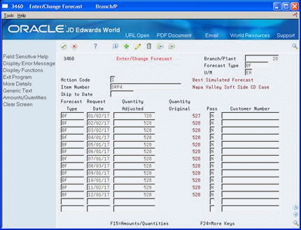

From Periodic Forecasting Operations (G3421), choose Enter/Change Forecast
After you generate and review a forecast, you can revise the forecast to account for changes in consumer trends, market conditions, competitors' activities, your own marketing strategies, and so on. When you revise a forecast, you can:
Change information in an existing forecast manually
Add a forecast
Delete a forecast
You can access forecasts that you want to revise by item number, branch plant, forecast type, or any combination of these elements. If your forecast is extensive, you can specify a beginning request date to limit the display.
As you revise the forecast, be aware that at least one of the following must be unique for each item number and branch record:
Forecast type
Request date
Customer number
For example, if two records have the same request date and customer number, they must have different forecast types.
On Enter/Change Forecast
To choose the forecast you want to revise, review the following fields:
Branch/Plant
Forecast Type
U/M (Unit of Measure) (Optional)
Item Number
Complete the following field:
Quantity Adjusted
To access amounts, choose Amounts/Quantities.
Revise the following field:
Amount Adjusted (F15)

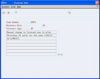

To enter descriptive text, access Forecast Text.
On Forecast Text, enter any descriptive text for the forecast.
