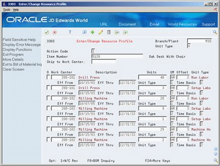

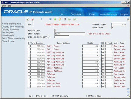

On Enter/Change Resource Profile
Figure 10-1 Enter/Change Resource Profile screen
Description of Figure 10-1 follows
Description of ''Figure 10-1 Enter/Change Resource Profile screen''
  1. Complete the following field:
    • Item Number
  2. Complete the following optional fields:
    • Work Center
    • Units
    • Unit of Measure
    • Offset
  3. Access the detail area (F4).
    Figure 10-2 Enter/Change Resource Profile (Detail) screen
    Description of Figure 10-2 follows
    Description of ''Figure 10-2 Enter/Change Resource Profile (Detail) screen''
  4. Complete the following optional fields or allow the system to enter a default:
    • Effective From
    • Effective Thru
    • Unit Type
    • Time Basis
Field Explanation
Units The quantity of units affected by this transaction.
Offset A value used in the Resource Profile table (F3303) to determine the number of days that the actual use of a work center resource should be offset from the forecasted need date.

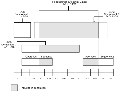

If you have defined bills of material (BOMs) and routings for an end item and all its subassemblies, you can run Generate Resource Profile to automatically generate the resource profile. The program calculates the load on a work center by extending the hours in the routing by the forecasted quantities for the master scheduled items.
Resource Profile Generation creates units of measure only in hours (HR). Enter the resource profile manually if you want to use other units of measure.
Generate Resource Profile changes or updates the resource profile using components with effectivity dates within the period that you specify. The specific items affected by the program are determined by the following factors:
  • The system retrieves routings only for BOM components that are effective within the range of effectivity dates in the processing options for the regeneration.
  • The system creates resource profiles only from BOM components with effectivity dates that are within the effectivity dates assigned to the item and the processing options.
  • The Effective From date in the resource profile is the latest of the dates in the processing option, the BOM, or the routing Effective From dates.
  • The resource profile Effective Through date is the earliest of the dates in the processing option, the BOM, or the routing Effective From dates.
The following graphic illustrates all the BOMs and routings with effectivity dates that are within the Effective From and Effective Through dates.
Figure 10-3 BOMs and Routings Within Effective From/Through Dates
Description of Figure 10-3 follows
Description of ''Figure 10-3 BOMs and Routings Within Effective From/Through Dates''
