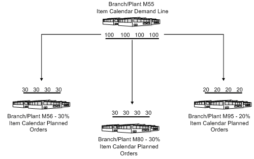

In the following example, the demand plant (M55) receives components from three different supply plants. Supply plants can also manufacture the end deliverable item.
Figure 41-1 Supply/Demand Plants
Description of Figure 41-1 follows
Description of ''Figure 41-1 Supply/Demand Plants''
A breakdown of the percent received from each supply branch/plant indicates that M55 satisfies 80 percent of its required demands from the three supply branch/plants. In this case, the demand plant assembly also supplies the remaining 20 percent of the end item.
