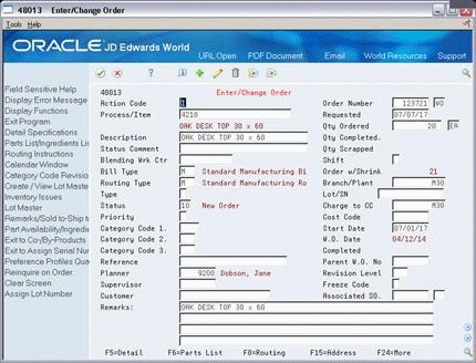

To enter identifying information
On Enter/Change Order
Complete the following fields:
Process/Item
Branch/Plant
| Field | Explanation |
| Item Number - Unknown Format Entered | A number that the system assigns to an item. It can be in short, long, or 3rd item number format. |
| Branch | A code that represents a high-level business unit. It can be used to reference a branch or plant that might have departments or jobs, which represent lower-level business units (data item MCU), subordinate to it. For example:
Business unit security is based on the higher-level business unit. Form-specific information For Shop Floor Control and Manufacturing Accounting: This field identifies the branch/plant in which the item resides. |
To enter scheduling information
If a scheduling problem exists on your work order, an error message appears. This message indicates that there is a difference between the work order start date and one or both of the following:
The start date of the first routing operation
The calculated start date for the work order, which indicates difficulty in back scheduling
Requested
Quantity Ordered
| Date - Requested | The date that an item is to arrive or that an action is to be complete.
Form-specific information For Shop Floor Control When you change the requested date:
To enter descriptive information
Descriptive information further identifies the work order, such as, its classification, priority, lot identification, parent item, and the revision level of its bill of material.
Complete the following optional fields:
Type
Priority
Remarks
Lot Number
Parent Work Order Number
Revision Level

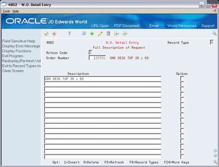

Choose Detail.
On W.O. Detail Entry, complete the following field to add detail text regarding the work order:
Description

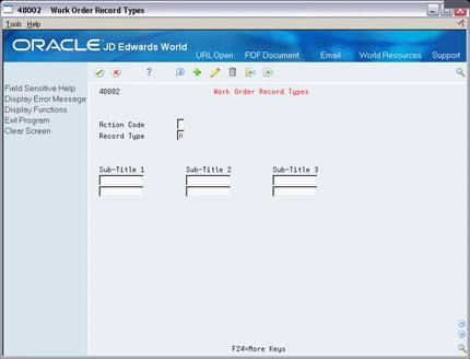

Figure 4-3 Work Order Records Type screen
On Work Order Record Types, complete the following fields to identify up to three additional headings for the detail form:
Subtitle I
Subtitle II
Subtitle III

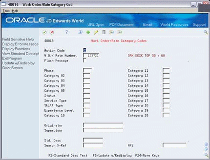

On Enter/Change Work Order choose Work Order Category Codes.
Figure 4-4 Work Order/Rate Category Codes
On Work Order Category Codes, complete the following optional fields:
Phase (Category Code 1)
Category Code 2
Category Code 3
Category Code 4
Category Code 5
Status
Service Type
Skill Type
Experience Level
Category Code 10
Originator
Supervisor
Standard Description
Search Cross Reference

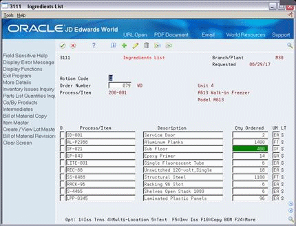

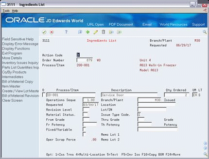

After you enter your work order header, you attach an ingredients list to it. You can attach ingredients lists:
Interactively, using a function key
Manually, entering the ingredients
In batch mode, using the Order Processing program
If a bill of material already exists in the system for the process, you can copy the bill of material information into the ingredients list. You can then attach this ingredients list to your work order header. You attach the ingredients list interactively using function keys.

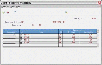

After you interactively attach the ingredients list, you can:

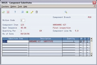

Specify or change a substitute item or quantities from different locations
Choose substitute items and their quantities on hand when an ingredient shortage is encountered
Use a processing option for Enter/Change Order to specify the substitute processing that you want to use:
Commit using the commitment control set in Manufacturing Constants
Commit using the commitment control set in Manufacturing Constants, but use substitutes for shortages
Commit using the commitment control set in Manufacturing Constants, but use substitutes if the quantity available can cover the shortage
Commit using the commitment control set in Manufacturing Constants, but display substitute availability when substitute quantity available can cover the shortage

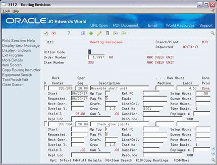

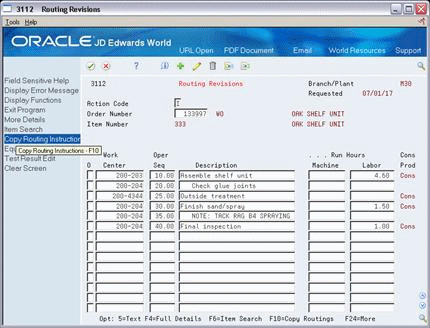

You can attach a work order routing from a routing master or enter it manually. The work order routing allows the entry of Employee Number and Machine Number. Actual cost orders will use the source for labor and machine rates from the Manufacturing Constants to determine these values. If employee rates and machine billing rates are chosen in the Manufacturing Constants and they are not entered, you will get a warning message and the system will use the 02 work center rates.
If you perform costing by work center, (the Cost by Work Center field is set to Y in the Manufacturing Constants program (P3009)) after this program attaches the parts list and routing instructions, it:
Creates the Standard and Current Costs at the work center level when Item Cost Detail (F30061) records exist.

Attaching the ingredients list interactively includes the following tasks:
Entering substitutions (optional)
Choosing substitute items (optional)
Entering multiple locations (optional)
To attach the ingredients list
Choose Ingredients.
On Ingredients List, use the appropriate function key to copy the bill of material.
Add the bill of material to the ingredients list.
Review the following fields:
Process/Item
Quantity Ordered
Description
Quantity Ordered Unit of Measure
Line Type
Choose More Details.
Figure 4-7 Ingredients List screen Including Bill of Material Information
Revision Level
Material Status
Location
Lot
Operations Sequence
Requested
Fixed/Variable
Issue Type Code
Branch/Plant
From Potency
Through Potency
From Grade
Through Grade
Supplier
Issue and Receipts

You can specify substitutions for the ingredients. To do this, enter the substitute quantities in the Component Item Substitutions form. If there is no quantity available, no information appears on this form.
Choose Parts List/Ingredients List.
On Ingredients List, choose Component Substitutes.
On Component Substitutes, complete the following field:
Quantity
Review the following default information:
Quantity Substituted
Unit of Measure
Item Number
Unit of Measure
Description
Quantity Available
| Unit of Measure as Input | The basic measurement used to designate the quantity of an inventory item. Examples are:
BA – bale LB – pound BG – bag MB – per thousand pieces BU – bundle MF – per thousand feet BX – box MW – per thousand weight CB – per hundred pieces PC – piece CF – per hundred feet PR – pair CS – per hundred square feet RL – roll CW – per hundred weight SF – square feet DM – drum SK – skein DZ – dozen TN – ton EA – each FT – feet |
| Quantity on Hand - Primary units | The number of units that are physically in stock. The quantity on-hand displays in the primary unit of measure. |
When the system encounters an ingredient shortage, you can choose the available substitutes and quantity. After you enter the information, the system adds the selected items and quantities to the ingredients list and deducts the equivalent quantity from the component. You cannot access this screen unless there is at least one quantity available.
Choose Work Order Ingredients List.
On Work Order Ingredients List, choose Substitute Availability.
Figure 4-9 Substitute Availability screen
On Substitute Availability, review the following information:
Quantity
Item
Quantity on Hand
Quantity Available
Change the following field as needed:
Quantity
Select the record to place the equivalent quantity for the component in the ingredients list.
The system calculates this quantity using the substitute item setup values (fixed or variable, partial, and so on).

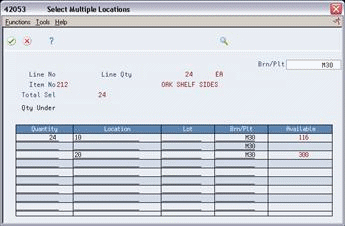

You can specify more than one commitment location for the ingredient. However, if you select a location that is not the primary location specified on the parts list, the system hard commits the item.
On Work Order Ingredients List, choose Select Multiple Locations.
Figure 4-10 Select Multiple Locations screen
On Select Multiple Locations, complete the following fields:
Quantity
Location
Lot
Branch/Plant
| Location | A code that identifies inventory locations in a branch/plant. You define the format of the location identifier by branch/plant.
Form-specific information If you select a location that is not the primary location specified on the parts list for a specific item, the system hard commits that item. |

To attach the routing instructions interactively
Choose Routing Revisions.
On Routing Revisions, choose the selection option to copy the routing.
Add the routing to the routing revisions.
Add the routing to your work order header.
Work Center
Operation Sequence Number
Description
Machine Run Hours
Labor Run Hours
Consumed/Produced/Both
Figure 4-12 Routing Revisions screen, Detail area
Equipment
Instruct Number
Start
Requested
Type Operation
Pay Point
Crew
Setup Hours
Queue Hours
Move Hours

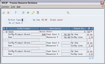

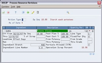

To set the resource percent for the co-products and by-products
Choose Co/By-Product Revisions.
Figure 4-13 Process Resource Revisions screen
On Process Resource Revisions, access the detail area.
Figure 4-14 Process Resource Revisions screen, Detail area
Complete the following optional field:
Resource Percent
| Co/By-Product/Intermediate | Distinguishes standard components or ingredients from co-products, by-products and intermediates. Valid values are:
C – Co-products are (concurrent) end items as the result of a process. B – By-products are items that can be produced at any step of a process, but were not planned for. I – Intermediate products are items that are defined as a result of a step but are automatically consumed in the following step. Generally, intermediates are non-stock items and are only defined steps with a pay-point for reporting purposes. Blank – Standard components (Discrete Manufacturing) or ingredients (Process) consumed during the production process. |
| Output Qty | The quantity of finished units that you expect this bill of material or routing to produce. This field allows you to specify varying quantities of components based on the amount of finished goods produced. For example, 1 ounce of solvent is required per unit up to 100 units of finished product. However, if 200 units of finished product are produced, 2 ounces of solvent are required per finished unit. In this example, you would set up batch quantities for 100 and 200 units of finished product specifying the proper amount of solvent per unit.
Form-specific information This value specifies the quantity of each co-/by-product that the process produces. If you use batch bills, this is the quantity that the batch produces. |
| Feat Cost % | A percentage used by the Simulate Cost Rollup program to calculate the cost of a feature or option item as a percentage of the total cost of the parent.
Enter the percentage as a whole number: 5% as 5.0 Form-specific information This value is used in Cost Rollup to calculate what percent of the cost, up to and including the operation, that the co-/by-product comes out of, is apportioned to the co-/by-products at that step. The total of all percentages at an operation cannot exceed 100%. The total of all percentages at the last operation must equal 100%. |
| Resource % | If this option is chosen, this value indicates what percent of the ingredients should be issued separately to co-products and by-products.
Form-specific information This is used to issue ingredients separately to co-/by-products at work order completion, rather than a total issue for each ingredient. For co-/by-products at the final operation, their resource percent must equal 100 to issue all ingredients. |

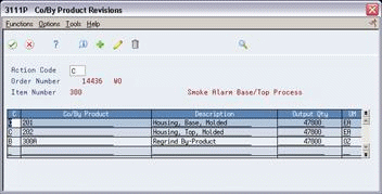

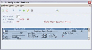

To attach the co-products and by-products
You can attach the co-products and by-products to the work order in one of two ways:
When the work order header is created, if you set the processing option to do so
When the ingredients list is attached to the work order header
Figure 4-15 Co/By Product Revisions screen
On Co/By Product Revisions, review the following fields:
Code
Co/By Product
Description
Output Quantity
Unit of Measure
Figure 4-16 Co/By Product Revisions screen, Detail area
| Co-Products/By-Products/Intermediate | Distinguishes standard components or ingredients from co-products, by-products and intermediates. Valid values are:
| Units - Order/Transaction Quantity | The quantity of units affected by this transaction. |

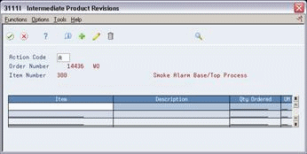

Use intermediates to track the quantity of output of any operation in a work center at a specific time. You can define intermediates in different units of measure and quantities. You set up one intermediate per operation. However, you cannot define an intermediate for the last operation.
An example of an intermediate is fermented liquid. The liquid ferments for an extended period of time before being distilled. The resulting liquid is not a finished product, but it proceeds to the next operation (similar to a phantom item).
You can attach intermediate records in a variety of ways:
Copy a bill of material, which automatically creates intermediate records.
Copy a routing, which automatically creates intermediate records.
Manually enter the intermediate items on the routing instructions or ingredients list.
Set a processing option to automatically create a parts list when you create work orders by answering detail messages in the Material Requirements Planning system. The intermediate records are automatically created as well.

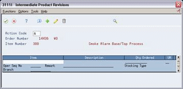

To attach the intermediate items
Choose Ingredients List.
On Ingredients List, choose Intermediate Product Revisions.
Figure 4-17 Intermediate Product Revisions screen
On Intermediate Product Revisions, complete the following fields:
Item
Quantity Ordered
Unit of Measure
Figure 4-18 Intermediate Product Revisions screen, Detail area
Form-specific information The quantity of the intermediate produced at this operation. |
| Unit of Measure | A user defined code (system 00/type UM) that identifies the unit of measurement for an amount or quantity. For example, it can represent a barrel, box, cubic yard, gallon, an hour, and so on. |
From Shop Floor Control (G31), choose Process Daily Order Preparation
From Daily Order Preparation - Process (G3113), choose Enter/Change Order

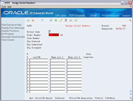

Alternatively, you can choose Assembly Serial Numbers from the Daily Order Preparation - Discrete menu (G3111). However, if you access Assembly Serial Numbers from the menu, you can use it only to locate existing serial numbers. You cannot update or add serial numbers when you access this program from the menu.
You assign serial numbers to your work orders to track serialized items within lots. You can assign serial numbers to work orders at any time. When you enter serial numbers, the system creates Serial Number Master records, as well as Work Order Lot/Serial Numbers (LSNs). The system does not validate any serial number that you enter until you complete the work order. If you do not assign a serial number to a serialized assembly, the system requires a number before you can complete the work order. After you complete a work order, you cannot modify any serial numbers that are assigned to the assemblies.
You can assign serial numbers to specific assemblies at any time prior to completing the work order using Assign Work Order LSN. You can also assign serial numbers to specific assemblies at the time of work order completions using Associate Issued Item LSNs. You can associate serialized components to a specific assembly either at inventory issues or work order completions. You must issue serialized components in their respective primary unit of measure to allow for association.
Assembly Serial Numbers assume a quantity of one in the unit of measure on the work order. For serialized assemblies, this will be the primary unit of measure. You cannot enter more serial numbers than the quantity on the work order.
Set the Lot Process Type and Serial Number Required fields on the Item Master Information screen for serial number processing
| Topic | Description |
| Deleting serial numbers | You can only delete serial numbers if there is no activity detected for the number. |
To locate the work order you want to assign serial numbers to, complete the following field:
Order Number
On Assign Work Order LSN's, choose Generate Serial Numbers to assign serial numbers to your work order.
To view the serial numbers that were assigned, relocate your order number.
