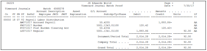

In addition to generating pro forma journal entries, this program generates the Timecard Journal Batch Proof report. You review this report to verify the accuracy of the transactions the system generated from the journal data. This report includes individual entries and totals for document type, period, the company, and a grand total for the batch report.

52.2 Rerunning the Timecard Journal Batch Proof Report
From Payroll Master (G07), choose Interims and Special Post
From Interims and Special Post (G0721), choose Print Journal Edit
You rerun the Timecard Journal Batch Proof report when you want to print the report without creating journal entries. This is the same report that the system prints when you generate the pro forma journals for timecards. You can rerun this report as many times as necessary.
To rerun the Timecard Journal Batch Proof report
On Print Journal Edit
To submit the job for processing, complete the following field:
  • Enter Batch Number to Print

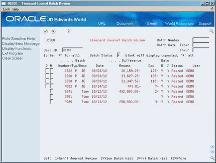

To review batch information
On Timecard Journal Batch Review
Figure 52-2 Timecard Journal Batch Review screen
Description of Figure 52-2 follows
Description of ''Figure 52-2 Timecard Journal Batch Review screen''
Display all batches for all users, or limit your search by completing one or more of the following fields:
  • User ID
  • Batch Number
  • Batch Date From
  • Batch Date Thru
  • Batch Status
Field Explanation
Batch Status A user defined code (98/IC) that indicates the posting status of a batch. Valid codes are:
blank – Unposted batches that are pending approval or have a status of approved.
A – Approved for posting. The batch has no errors, is in balance, but has not yet been posted.
D – Posted. The batch posted successfully.
E – Error. The batch is in error. You must correct the batch before it can post.
P – Posting. The system is posting the batch to the general ledger. The batch is unavailable until the posting process is complete. If errors occur during the post, the batch status is changed to E (error).
U – In use. The batch is temporarily unavailable because someone is working with it.
