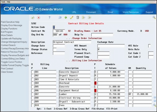

On Contract Billing Line Details
Figure 14-1 Contract Billing Line Detail (Revise Billing Lines) screen
Description of Figure 14-1 follows
Description of ''Figure 14-1 Contract Billing Line Detail (Revise Billing Lines) screen''
  1. To locate a contract and change order, complete the following fields:
    • Contract Number
    • Change Order Number
    If you inquire using only Contract Number, then Change Order 000 displays.
  2. Revise the billing line.
    You cannot revise the following fields:
    • Billing Line
    • Pricing Type
    • Contract Number

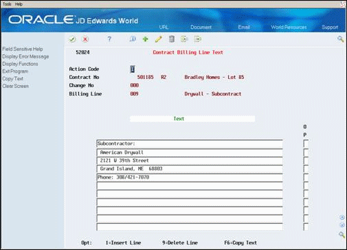

  2. Choose Text (Option 1) for a billing line.
    Figure 14-2 Contract Billing Line Details (Change Order) screen
    Description of Figure 14-2 follows
    Description of ''Figure 14-2 Contract Billing Line Details (Change Order) screen''
  3. On Contract Billing Line Text, enter the text.
    After you enter the free-form text, the system highlights the Option field next to the billing line to indicate that text is associated with that line.
  3. On Contract Billing Line Text, choose Copy Text (F6).
    Figure 14-3 Contract Billing Line Details (Copy Text) screen
    Description of Figure 14-3 follows
    Description of ''Figure 14-3 Contract Billing Line Details (Copy Text) screen''

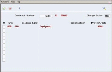

  4. On Copy Billing Line Text, complete the following field to identify the contract from which you want to copy text:
    • Contract Number
  5. Complete the following optional field:
    • Change Number
    The system displays the related billing lines that include associated text.

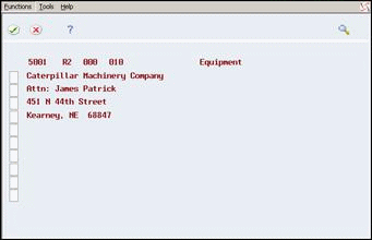

  6. On Copy Billing Line Text, choose Detail (Option 1) for the billing line to display all the lines of text.
    Figure 14-4 Billing Line Display screen
    Description of Figure 14-4 follows
    Description of ''Figure 14-4 Billing Line Display screen''
  7. Choose Select (Option 4) for one or more lines of text to copy specific lines.
    The system automatically updates the Contract Billing Line Text window with the lines of text that you specify.

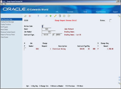

  2. Choose Change Management Inquiry (F8).
    The system displays Change Request Revenue Detail with any change requests that exist for the contract.
    Figure 14-5 Change Request Revenue Detail screen
    Description of Figure 14-5 follows
    Description of ''Figure 14-5 Change Request Revenue Detail screen''
  3. On Change Request Revenue Detail, choose Return with Number (Option 4) for the change request.
