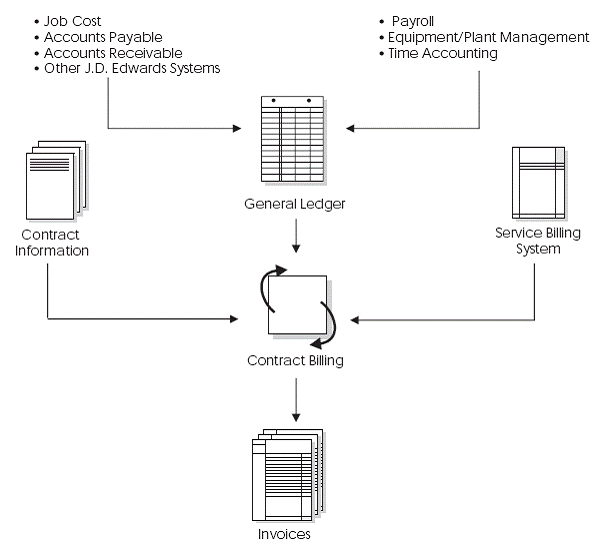

The following graphic illustrates the system integration between Contract Billing and other JD Edwards World systems.
Figure 5-1 Contract Billing Integration
Description of Figure 5-1 follows
Description of ''Figure 5-1 Contract Billing Integration''
