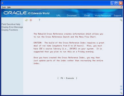

To generate the cross-reference index
Navigation
From Rebuilds and Global Updates (G9642), choose Cross-Ref Index
Choose Execute (F6).
Figure 29-1 Rebuild Cross Reference screen
Description of Figure 29-1 follows
Description of "Figure 29-1 Rebuild Cross Reference screen"
