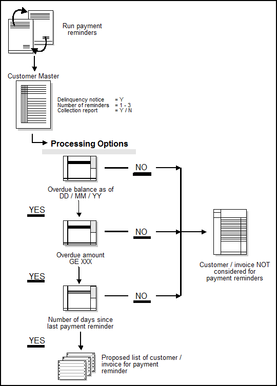

You can set up text for payment reminders by company or by customer. In the customer master record, you indicate how many reminders you want the customer to receive. The system generates payment reminders based on information in the A/R Ledger file.
The following graphic illustrates how customers or invoices are selected for payment reminders.
Figure 28-1 Payment Reminders Process
Description of Figure 28-1 follows
Description of "Figure 28-1 Payment Reminders Process"
