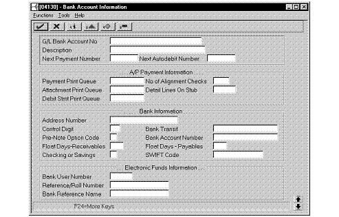

To enter bank account information for your company
On G/L Bank Account Information
Figure 20-1 Bank Account Information screen
To enter the bank information for a customer, complete the following fields:
G/L Bank Account Number
Description
Complete the following fields:
Address Number
Control Digit
Bank Transit
Pre-Note Option Code
Bank Account Number
Float Days - Receivables
Checking or Savings Account
SWIFT Code

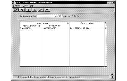

To enter bank account information for customers and suppliers
On Bank Account Cross Reference
Figure 20-2 Bank Account Cross-Reference screen
To locate a customer or supplier, complete the following field:
Address Number
To enter bank account information, complete the following fields:
Transit Number - Bank
Bank Account Number
Bank Account Control Digit (optional)
Description
Record Type - Bank Transit
