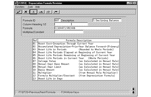

To define formulas for user defined depreciation
On Depreciation Formula Revision

  1. To set up or review an existing formula, complete the following field:
    • Formula ID
    Choose the field-sensitive help for Formula ID to review a list of valid formulas or to search for a specific formula by code or description.
  2. To define or revise the formula, complete the following fields:
    • Description
    • Formula
    • Multiplier/Constant
