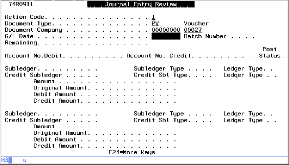

14.3 Correspondence Journal Entry Review (P74R0911)
The Correspondence Journal Entry Review program (P74R0911) allows users to review online a correspondence journal entry. The program allows changes to correspondence distribution amounts, but will not allow users to add lines or remove entries. Once the correspondence journal entry is posted, no more changes will be allowed.
Figure 14-1 Journal Entry Review screen
Description of Figure 14-1 follows
Description of "Figure 14-1 Journal Entry Review screen"
To review correspondence journal entries
Navigation
From (G74R09), choose option 14 (Journal Entry Review)
  1. Type I (Inquiry) in the Action Code field.
  2. Complete the following:
    • Document Type
    • Document - Enter the document number for the journal entry.
    • Company - Enter the company number.
    • G/L Date - Enter the general ledger date of the journal entry.
  3. Press Enter to display the selected journal entry.
