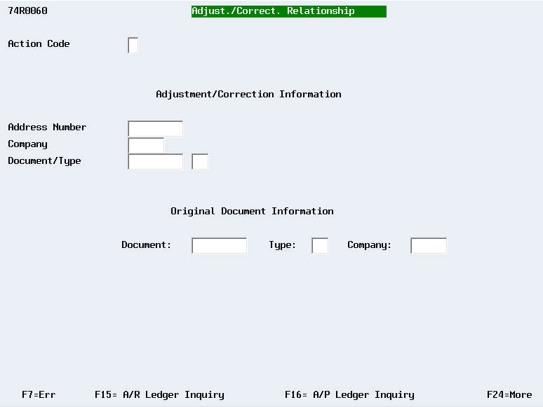

Use the Adjustment/Correction Relationship (P74R0060) program to associate both adjustment and correction documents with an original document.
Figure 8-1 Adjustment/Correction Relationship screen
To associate adjustments/corrections
From (G74R03), choose option 18 (Adjust./Correct. Relationship)
From (G74R04), choose option 8 (Adjust./Correct. Relationship)
Type A (Add) in the Action Code field.
In the Adjustment/Correction Information section, complete:
Address Number -Enter the supplier or customer AB record.
Company -Enter your company number.
Document/Type - Enter the adjustment/correction document number and type.
In the Original Document Information section, complete:
Document -Enter the number of the original document.
Type -Enter the document type of the original document.
Press Enter to save the information.
