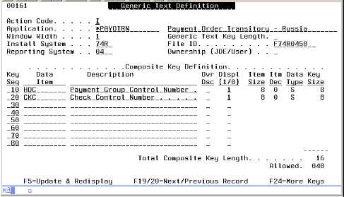

The generic text definitions entered through the memo function
Figure 5-1 Generic Text Definitions screen
To verify generic text setup for Payment Order Transitory - Russia
From Developer's Workbench (G9362), choose option 9 (Generic Text Definitions)
Select action code I (Inquiry).
Enter Application *PAYOTRN and press Enter.
Verify that the system displays the information shown in the screen example above.

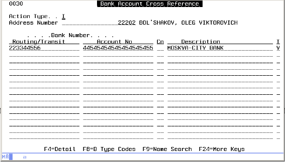

You must set up bank account cross-references for suppliers who receive payment orders. These cross-references supply bank account information for your suppliers. You can also add this information on Supplier Master Information.
Bank account cross-references link supplier addresses in the Address Book Master file (F0101) to their bank account information in the Bank Transit Number Master file (F0030).
Figure 5-3 Bank Account Cross Reference screen
From Automatic Payment Setup (G04411), choose option 7 (Bank Account Cross-Reference)
Select action code A (Add).
Complete the following:
Address Number - Enter the vendor Address Book number. The Address Book number identifies the vendor in the system and links to the mailing address information for the vendor.
Routing/Transit - Enter the routing and transit (Russian BIK) number that identifies the bank and links to the bank's correspondent account that prints on the payment order.
Account No. - Enter the vendor's bank account number.
Description - Enter a short description to identify the vendor's bank.

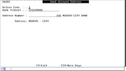

Press F8-B Type Codes to display the Bank Account Addresses screen. This screen links the Bank Transit (BIK) number and the bank's name and address through the Address Book number.
Bank Transit - Enter the routing and transit (Russian BIK) number that identifies the bank and links to the bank's correspondent account that prints on the payment order.
Address Number - Enter the Address Book number of the vendor's bank. The Address Book number identifies the bank in the system and links to the mailing address information for the bank.
Press Enter to accept the information and return to the Bank Account Cross-Reference screen.
Press Enter to save the information and clear the screen.

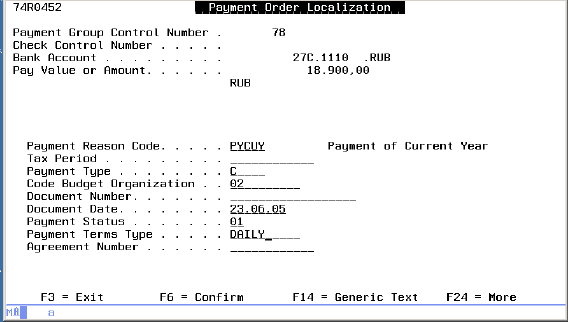

The new window, Payment Order Localization appears.
Note: If you select option 1 (Pmts) on Work with Payment Groups, the Review Payment Group - Write screen displays. When you select option 3 (Write), from Review Payment Group - Write, the Payment Order Localization screen that appears also shows the check control number, payee address number, G/L date, and company. The information entered applies only to that particular payment. When using option 3 from the more generic Work with Payment Groups, the information entered applies to all payments in that group. |
Figure 5-5 Payment Order Localization screen
Note: Most of these fields are only used when making payments to the Tax authorities so will normally be left blank. |
To enter payment order supplemental data for Russia
On Payment Order Localization, complete the following fields:
Payment Reason Code - Enter a code or press F1 to select a code from the Payment Reason Code list.
Payment Type - Enter the code to specify the payment type.
Code Budget Organization - Enter a code or F1 to select a code from the Code Budget Organization list.
Payment Status - Enter a code or press F1 to select a code from the Payment Status list.
Payment Terms Type - Enter a code or press F1 to select a code from the Payment Terms Type list.
Tax Period - Enter the tax period for the payment.
Document Number - Enter the document number of the payment.
Document Date - Enter the document date.
Agreement Number - Enter the agreement number that applies to the payment.

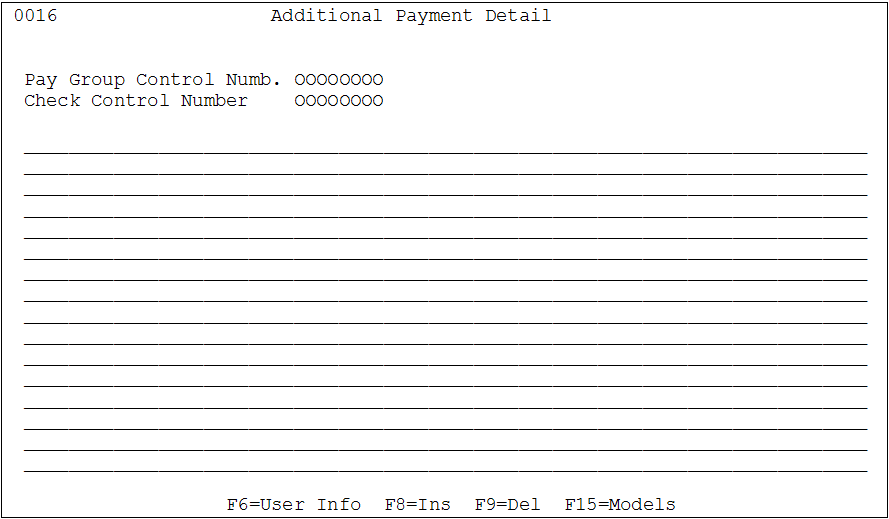

To add a text comment to the Payment Order, complete the following optional steps. Otherwise, skip to step 3. The text you enter in the Additional Payment Detail window will be printed on the Payment Order.
Press F14 (Generic Text) to display the Payment Order Transitory - Russia window (similar to the layout example, below).
Enter the additional text you want to print on the payment order and press Enter to save the text and return to the Payment Order Localization window.
Figure 5-6 Additional Payment Detail screen
Note: Additional text entry is optional. There is no limit for the length of text you can enter. All text entered is printed. If no text is entered here, the memo text description from the UDC code used for Payment Terms Type is printed on the payment order. The memo text for payment terms types can be entered as described under Set Payment Terms Type (74R/PT) in the Setting Up User-Defined Codes for Payment Processing section of this document. |

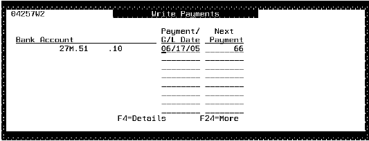

The system displays the Write Payments window.
Enter the Payment Order Date and press Enter to submit the payments to processing.

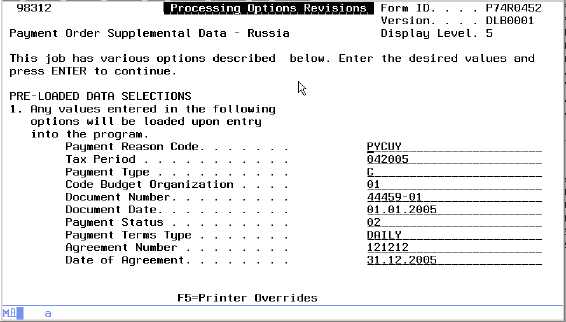

Figure 5-8 Processing Options Revisions screen
Note: The DREAM Writer version you configure for pre-loaded data selections must be the same version that is called by the Work with Payment Groups (P04257) version from which you print the payments. If the pre-loaded data selections are blank, or if another version of P74R0452 is used to print the payments, these fields will appear blank on the Payment Order Localization window (74R0452). |
Any values entered in the following options will be loaded upon entry into the program.
| Processing Option | Explanation |
| Payment Reason Code | Use this processing option to enter a payment reason code. The value that you enter must exist in the Payment Reason Code (74R/PR) UDC table. |
| Tax Period | Use this processing option to enter the tax period for the payment. |
| Payment Type | Use this processing option to enter a payment type code. |
| Code Budget Organization | Use this processing option to enter a budget organization code. The value that you enter must exist in the Code Budget Organization (74R/BO) UDC table. |
| Document Number | Use this processing option to enter the document number of the payment. |
| Document Date | Use this processing option to enter the document date. |
| Payment Status | Use this processing option to enter a payment status code. The value that you enter must exist in the Payment Status (74R/PS) UDC table. |
| Payment Terms Type | Use this processing option to enter a payment terms type code. The value that you enter must exist in the Payment Terms Type (74R/PT) UDC table. |
| Agreement Number | Use this processing option to enter the agreement number. |
| Date of Agreement | Use this processing option to enter the date of the agreement. |

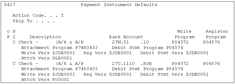

Verify that your User Display Preference is set to RU (Russia).
Payment instrument (C) must have the payment order printing program (P74R0453) defined in the "Attachment Program" field. To define payment instruments for automatic payments go to menu G04411 (Automatic Payment Setup) and select option 4. Display the fold area as illustrated in the following example.
Figure 5-9 Payment Instrument Defaults screen
Set up bank account information and relationships for suppliers and company. See Section 5.4, "Setting Up Bank Accounts for Payment Order Processing" for more information.
Complete the following program and version information for payment orders:
Write Program - Enter program that is used to write the payments (P04572).
Write Vers (Write Version) - Enter the DREAM Writer version that is used for P04572.
Attachment Program - Enter the program that is used to print payment order attachments (P74R0453).
Attach Vers (Attachment Version) - Enter the DREAM Writer version that is used for P74R0453.

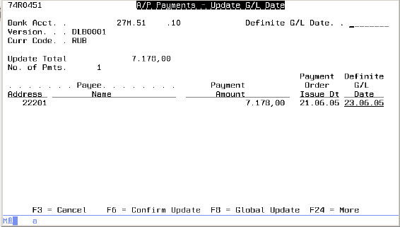

To automatically print the payment order
Write payments from the Work with Payment Groups (P04257) program.
Enter 3 (Write) in the Option field next to each payment to write, or press F10 to write all payments in the pay group.
The system displays the Payment Order Supplemental Data RUS 04 screen.
Enter the required supplemental data for each payment in the group by selecting each payment, then entering the supplemental data.
When you press F6 to confirm, the system saves the data that you enter to the Payment Order Supplemental Data (F74R0450) file, runs the Automatic Payment Order (P74R0453) program and prints the Payment Order document.
This section provides an overview of the payment GL date and discusses how to:
Individually update the payment G/L date.
Globally update the payment G/L date.
In Russia, the bank statement is the only document used to confirm general ledger bank account transactions. The payment order G/L date must be equal to the bank statement date even when the payment order is issued with a different payment date.
Oracle JD Edwards World provides a program that lets you modify the payment G/L date after payments are written. A typical scenario for changing the G/L date might be:
On June 1, write payments using the Work with Payment Groups program (P04571).
On June 2, send payment orders to the bank.
On June 6, receive executed payment orders and bank statements that show the actual payment date of June 5.
Locate payment records for the transactions in the bank statement and change the G/L date for the transactions from June 1 to June 5 to show the date the payment actually occurred.
Note: You can update the G/L date only for payments that are at an Update status. In the localization for Russia, the final Update process of the automatic payment processing procedure has been modified to allow users to globally revise the payment date for payments in a payment group or to overwrite the payment date for individual payments. |
| Program Name | Navigation | Usage |
| Work with Payment Groups | Automatic Payment Processing (G0413), Work with Payment Groups (P04257). | Choose a record, or process multiple records. |
| Work with Payment Groups - Update Status | Select a record on the Work with Payment Groups screen. Execute selection option 4 (Update). | Choose a record. |
| Update G/L Date | Access the A/P Payments - Update G/L Date program (P74R0451). | Update the G/L date. |
The localization program P74R0451 is accessed through 'Work with Payment Groups' (P04257) when the 'Update' function is selected. It is a requirement for all payment orders to update the payment G/L date to match the payment date information provided by the bank.
Figure 5-10 A/P Payment - Update G/L Date screen
To individually update payment G/L dates
From Automatic Payment Processing (G0413), choose Work with Payment Groups
Enter the date provided by the bank statement in the Definite G/L Date field to update the G/L date for the selected payment(s). The date must be greater than or equal to the Payment Order Issue Date.
Press F6 to confirm update.
The global update allows you to update all the payments within the group to the same date. After you have updated the whole group it is possible to amend individual payments if required. The revised date must be greater than or equal to any of the individual payment order dates inside the group.
To globally update payment G/L dates
From Working with Payment Groups, choose Option 4 (Update) for the payments that you want to change
Press Enter.
On A/P Payments - Update G/L Date, enter the date provided by the bank statement in the upper Definite G/L Date field (header section).
Press F8 (Global Update).
Press F6 to confirm the update.
