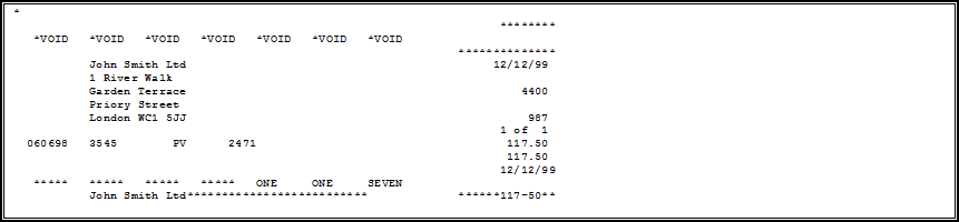

In the following example, the processing options are set to omit the address and print the payee's name below the amount in words.

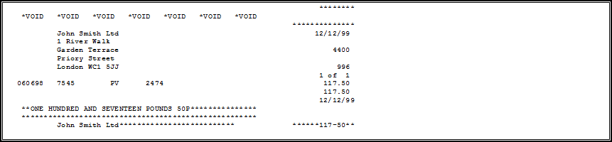

In the following example, the processing options are set to print the address and print the payee's name above the amount in words.
Figure 17-2 APACS Check Format (Payee's Name Above Amount)

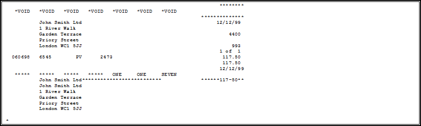

In the following example, the processing options are set to print the address and print the payee's name below the amount in words.
Figure 17-3 APACS Check Format (Address and Payee Below Amount)
