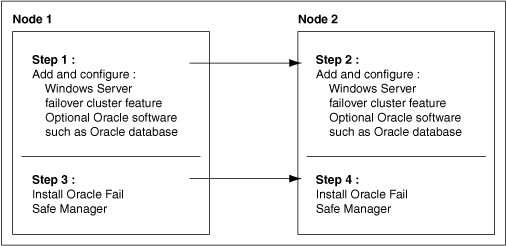

Although this guide describes the Oracle Fail Safe installation in detail, other products must also be installed to implement the Oracle Fail Safe environment. Figure 1-1 shows the recommended order for installing software on a two-node cluster
The numbers in Figure 1-1 do not correspond to the numbered steps in the subsequent list because the list contains more detailed information than the figure.Figure 1-1 Recommended Order for Installing Software on a Two-Node Cluster
The following list provides more detail about the installation order and other tasks to help you get started with Oracle Fail Safe:
On each cluster node, add and configure the Microsoft Windows Failover Cluster feature.
See Oracle Fail Safe Release Notes for Microsoft Windows for information about the versions of Microsoft Windows that can be used with Oracle Fail Safe.

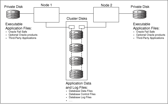

On each cluster node, install the optional Oracle software (Oracle Database and other applications) that you plan to use with Oracle Fail Safe. Place all application and database data, control, and log files on shared cluster disks so that they can fail over. If you add an Oracle product after Oracle Fail Safe has started, then you must restart Oracle Fail Safe so it can identify the new installation. This can be done by restarting the Cluster Service action on each node in the cluster. Restarting the Cluster Service will force all cluster groups on a node to failover to another node.
If you are installing Oracle Database software, you can create the database before or after you install Oracle Fail Safe. Create the database as you would in a noncluster environment, including the database listener. However, the database must be created on a cluster disk or disks.
On each cluster node, install the server component of Oracle Fail Safe.
See Chapter 2 for complete information about installing Oracle Fail Safe.
On one or more client systems, optionally, install Oracle Fail Safe Manager (for example, to set up additional management consoles).
Figure 1-2 lists the software and the files that should be installed on private disks and shared-nothing cluster disks.
Figure 1-2 Software Installed on Private, Shared-Nothing Cluster Disks
If you want to add a node to an existing cluster, perform the following operations:
Follow Microsoft's instructions to add a node to a cluster.
On the new node, install any desired optional Oracle software (Oracle Database and other applications) that you plan to use with Oracle Fail Safe. Install executable application files located on private disks (for example, on the system disk for each node).
On the new node, install the server component of Oracle Fail Safe. You can install Oracle Fail Safe Manager at the same time.

Configure application data and log files on the shared cluster disks.
Configure alert and trace files on either the shared cluster disks or on the private disk.
Configuring alert and trace files on private disks allows the administrator to determine the node on which problems occur, but requires that you maintain multiple sets of files. Placing parameter files on private disks is recommended only when you want the parameters to be different on each cluster node. For example, this can be useful if you want a database to use fewer resources on its failover node than on its primary node (such as when you know that another application or database on the failover node needs resources).
