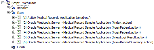

  6. Click Finish. OpenScript creates the script project and shows the Initialize, Run, and Finish nodes in the Script View as follows:
    Figure 3-1 OpenScript Script Project Tree

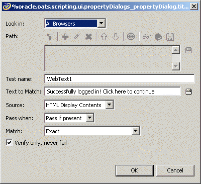

  8. Click the Text Matching Test button on the OpenScript floating toolbar.
  9. Enter WebText1 as the Test name.
  10. Enter Successfully logged in! Click here to continue as the Text to Match.
  11. Make sure Source is set to HTML Display Contents.
  12. Make sure Pass when is set to Pass if present.
  13. Make sure Match is set to Exact.
  14. Make sure Verify only, never fail is selected.
  15. Click OK.

    Figure 3-2 OpenScript Script Tree After Recording
    Description of "Figure 3-2 OpenScript Script Tree After Recording"

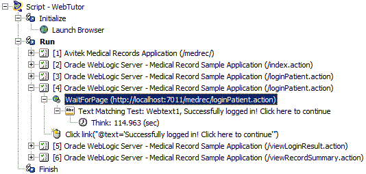

  3. Expand the [4] (/loginPatient.action) Step Group and select the WaitForPage (http://systemName:7011/medrec/loginPatient.action) node as follows:
    Figure 3-5 Script Tree with Expanded Step Group Node
    Description of "Figure 3-5 Script Tree with Expanded Step Group Node"
    The Step Group node shows the actions and parameters recorded for specific navigations and actions on a Web page.
    The Details View tabs show the details for a specific navigation including a screen shot of the recorded page, the HTML source, and the browser rendering of the page.
  4. Click the Screenshot, HTML, and Browser tabs to view the script details.
  5. Expand the WaitForPage (http://systemName:7011/medrec/loginPatient.action) node. The script records Think time nodes to include the amount of user delay that occurred during recording as follows:
    Figure 3-6 Script Think Node
    Script Think Node
    Description of "Figure 3-6 Script Think Node"

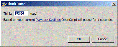

  6. Select the Think node, click the right mouse button and select Properties. The Think time properties lets you edit the delay recorded to a script as follows:
    Figure 3-7 Script Think Node Properties
    Description of "Figure 3-7 Script Think Node Properties"
  7. Change the Think time value and click OK. This is useful if you want to reduce long a delay time that may have occurred during recording of script.

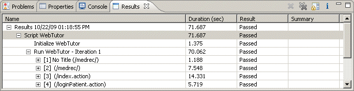

3.5 Example 3: Playing Back a Web Functional Test Script
This example explains the procedure for playing back Web Functional Test scripts that you have recorded. It also shows the results log. Web Functional Test scripts perform actions on browser objects. During playback, the browser will open and you will be able to watch as script actions occur.
To play back an OpenScript script:
  1. Select Playback from the Script menu or click the Playback toolbar button to play back the recorded script. The navigations and actions in the script Step Groups will be played back in the order recorded. The Browser navigates to each page, executes the any tests for each page, and shows the results in the Result view.
  2. When playback finishes, expand the Results tree to view the results for each Step Group as follows:
    Figure 3-9 Script Playback Results in the Results View
    Description of "Figure 3-9 Script Playback Results in the Results View"
    The "passed" results indicate that all referenced resources are available. Oracle OpenScript automatically generates a results report and opens the report in the Details view.

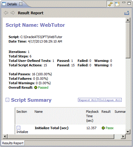

  3. Select the top-level Result node or the script name in the Results view to view the results report in the Details view as follows:
    Figure 3-10 Results Report in the Details View
    Description of "Figure 3-10 Results Report in the Details View"

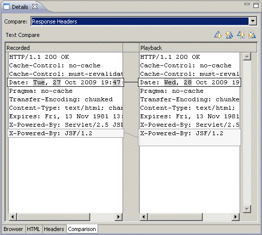

    Notice that all tests passed. This is because you played back the script using the same version of the Web pages that was used to record the script. This establishes a baseline of tests for the Web application or Web site's content and structure.
  4. Expand the Run node in the Results view then expand the results for Step Group [4] (/loginPatient.action).
  5. Select the WaitForPage node under [4] (/loginPatient.action). The Details view shows the results for the specific Step Group.

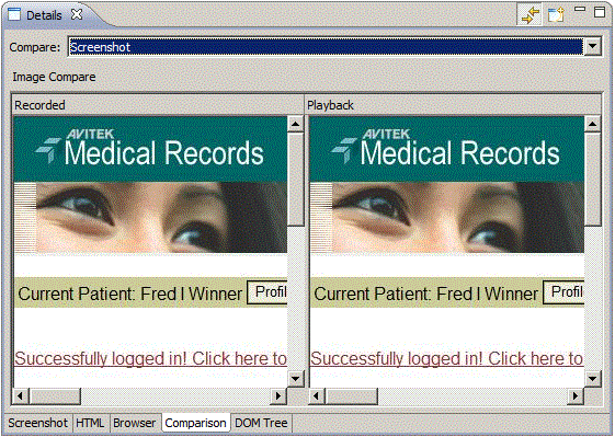

  6. Click the Comparison tab in the Details view. The Comparison tab lets you compare the recorded HTML content, screenshots, and browser renderings of page navigations to the play back values as follows:
    Figure 3-11 Details View Showing the Web Functional Test Comparison Tab
    Description of "Figure 3-11 Details View Showing the Web Functional Test Comparison Tab"
  7. Select the Content and Browser options in the Compare list to compare the recorded and playback HTML source and browser renderings of the page.

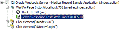

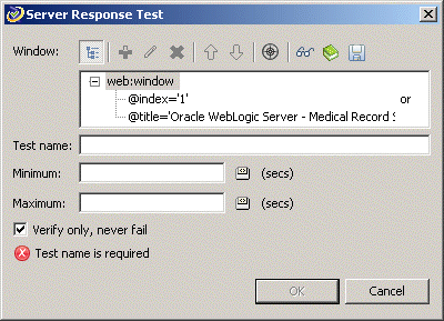

3.6.1 Inserting a Server Response Test Case
Server Response test cases measure the response time of a server access for a page in the script.
To add a Server Response test:
  1. Expand the [2] (/medrec/) Step Group in the script tree.
  2. Select the WaitForPage (http://systemName:7011/medrec/index.action) node.
  3. Select Add from the Script menu, then select Other.
  4. Expand the Web Tests folder, select Server Response Test, and click OK. OpenScript opens the Server Response Test properties dialog box as follows:
    Figure 3-12 Server Response Test Properties Dialog Box
    Description of "Figure 3-12 Server Response Test Properties Dialog Box"
  5. Type WebTimer1 as the test case name.
  6. Set the Minimum time to 0 seconds.
  7. Set the Maximum time to 5 seconds.
  8. Click OK and view the test in the script. OpenScript adds the test to the Step Group as follows:
    Figure 3-13 Server Response Test Added to the Script Tree
    Description of "Figure 3-13 Server Response Test Added to the Script Tree"

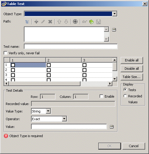

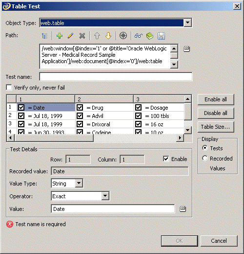

3.6.2 Inserting a Table Test
Table test cases let you define a custom test on a Web page table object. The Table Test properties lets you select the table object directly from the Web page by highlighting it with the mouse. The properties also let you specify the table object property to test and the type of test to perform.
To add a Table test:
  1. Expand the [5] (/viewLoginResult.action) Step Group in the script tree.
  2. Select the WaitForPage (http://systemName:7011/medrec/patient/viewLoginResult.action) node.
  4. Expand the Web Tests folder, select Table Test, and click OK. OpenScript opens the Table Test properties dialog box as follows:
    Figure 3-14 Table Test Properties Dialog Box
    Description of "Figure 3-14 Table Test Properties Dialog Box"
  5. Click the select Capture object in browser button next to the Path field and select Capture Object from the menu. The capture mode starts.
  6. Open the Medical Records Sample Application (http://systemName:7011/medrec/) in the browser window (which should still be open from the previous example).
  7. Click Start using MedRec! to navigate to the page with the table data.

  13. Move the mouse over the Prescriptions table so that the table is highlighted.
  14. Press F10 to capture the object path in the Select Object dialog box.
  15. Click OK. The object path for the Medical Records Sample Application web page table is added to the Table Test properties as follows:
    Figure 3-15 Table Test Properties Dialog Box with Captured Data
    Description of "Figure 3-15 Table Test Properties Dialog Box with Captured Data"
    The Table Test properties lets you enable or disable testing for each table cell individually. The Test Details section shows the details for the currently selected table cell.
  16. Clear the check boxes for all of the data items in rows 2, 3, and 4 (scroll the table as necessary). This will perform the testing on heading rows but not the data rows.
  17. Enter WebTable as the Test name.
  18. Click OK and view the test in the script. OpenScript adds the test to the script [6] (/viewLoginResult.action) Step Group as follows:

  21. Playback the script and verify that all tests pass.

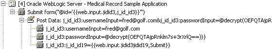

3.8.3 Viewing the Parameters in the Script
To view the script parameters:
  1. Expand the [4] Oracle WebLogic Server - Medical Record Sample Application Step Group in the script tree. Notice the parameters under the Post Data node of the tree as follows:
    Figure 3-17 Script Parameter Values for HTTP Post Data
    Description of "Figure 3-17 Script Parameter Values for HTTP Post Data"
The usernameInput and passwordInput parameters can be mapped to a databank file to pass data from an external file.

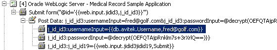

3.8.6 Mapping Script Parameters to Databank Fields
After configuring a databank in a script, you can map the databank fields to specific script parameters.
To map databank fields to script parameters:

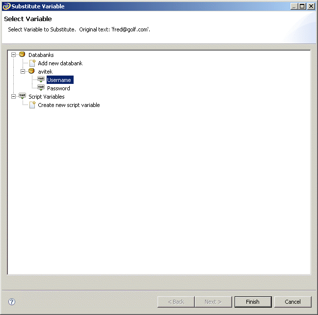

  1. Expand the [4] Oracle WebLogic Server - Medical Record Sample Application script tree node.
  2. Right-click the usernameInput parameter and select Substitute Variable. The Substitute Variable window opens with the databank field names listed as follows:
    Figure 3-18 Substitute Variable Window
    Description of "Figure 3-18 Substitute Variable Window"
  3. Select the Username field and click Finish. The parameter value changes to a databank variable in double braces{{db.avitek.Username,fred#@golf.com}} as follows:
    Figure 3-19 Script Parameter with a Mapped Databank Variable
    Description of "Figure 3-19 Script Parameter with a Mapped Databank Variable"
  4. Right-click the passwordInput parameter and select Substitute Variable. The Substitute Variable window opens with the databank field names listed.
  5. Select the Password field and click Finish. The parameter value changes to a databank variable in double braces{{db.avitek.Password,weblogic}} as follows:
    Figure 3-20 Script Parameters with Multiple Mapped Databank Variables
    Description of "Figure 3-20 Script Parameters with Multiple Mapped Databank Variables"

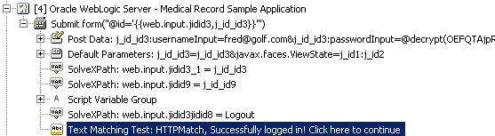

3.8.7 Inserting a Text Matching Test
Now we want to insert a Text Matching text case that verifies that the login results were successful.
  1. Select the Submit form ("@id='j_id_id3") node under the [4] Oracle WebLogic Server - Medical Record Sample Application script tree node. The page appears in the Details view.
  2. Select Add from the Script menu then select Other.
  3. Select Text Matching Test in the HTTP Tests folder and click OK.
  4. Enter HTTPMatch as the test name.
  5. Enter Successfully logged in! Click here to continue as the Text to Match.
  6. Make sure the Source options is HTML Display Contents.
  7. Make sure the Pass When option is Pass if Present.
  8. Make sure the Match option is Exact.
  9. Click OK. The Text Matching test node appears in the script tree at the end of the Step Group as follows:
    Figure 3-21 Script Tree with a Text Matching Test Node
    Description of "Figure 3-21 Script Tree with a Text Matching Test Node"
  10. Save the script.

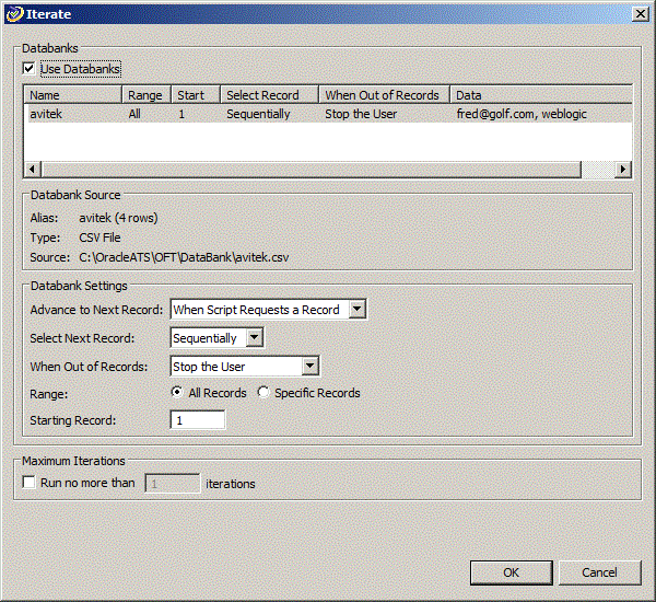

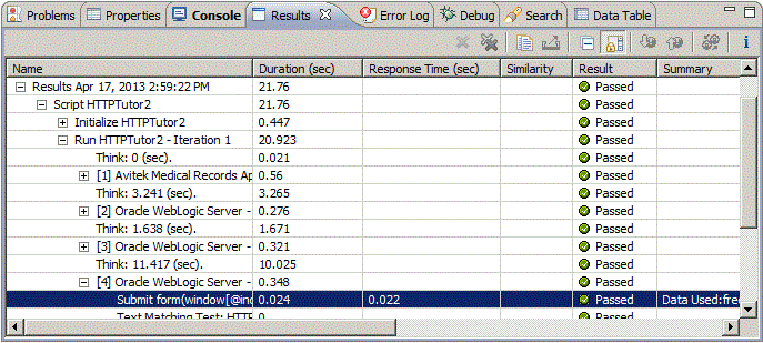

3.8.8 Playing Back the Script with Iterations
Now that the script has a databank mapped to the Post Data parameters, we can play back the script with multiple iterations to use all of the values in the databank file.
To play back the script with iterations:
  1. Select Iterate from the Script menu. The Iterations dialog box opens as follows:
    Figure 3-22 Iterations Dialog Box
    Description of "Figure 3-22 Iterations Dialog Box"
  2. Make sure Use Databanks is selected.
  3. Make sure Range is set to All Records.
  4. Make sure the Starting Record is set to 1.
  5. Make sure the Run no more than [] iterations is selected and set to 1.
  6. Click the OK button to playback the script with multiple iterations.

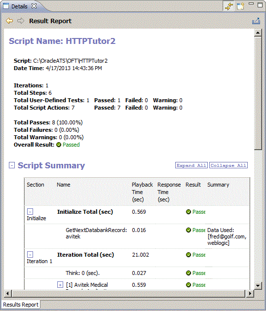

  7. Watch the Details view as the script plays back the script several times using a different data value for the login each time.
  8. View the playback results in the Results view. At the end of playback the Details view shows the results report similar to the following:
    Figure 3-23 Results Report for Multiple Iterations
    Description of "Figure 3-23 Results Report for Multiple Iterations"

  10. Click the tabs in the Details view. The Comparison tab for HTTP scripts lets you compare the recorded HTML content, Request Headers, Response Headers, and Cookies to the playback values as follows:
    Figure 3-25 Details View Showing the HTTP Test Comparison Tab
    Description of "Figure 3-25 Details View Showing the HTTP Test Comparison Tab"
