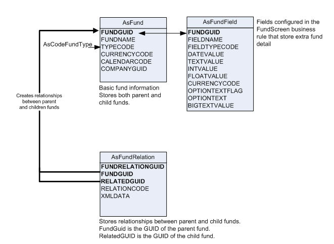

Plan fund information such as removal method, removal precedence and deposit level tracking are handled at the parent fund level. Plan fund status records are not created in the AsPlanFund table for child funds. All child funds adhere to the plan fund status information set for the parent fund.
OIPA Fund Database Tables
