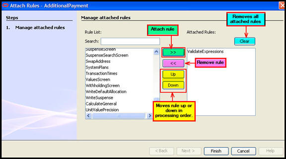

Attach Rules Manager
Attach Rules Window
Steps to Edit Attached Rules
  1. Expand the associated transaction folder in the Main Explorer.
  2. Right-click on the transaction’s XML file.
  3. Select Edit Attached Rules. The rule must be checked-in to see this option.
  4. Select the rule to remove from the Rule List.
  5. Use the button to remove a rule button to remove a rule.
  6. Repeat as necessary.
  7. Select Finish. The Attached Rules node may disappear from the navigation tree. If this happens, logout and log back into the Rules Palette to refresh the navigation tree.
