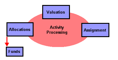

The Assignment pane allows for visual configuration of assignments that are made to a policy through transaction processing. The Assignment element, located in the transaction XML, describes how values should be assigned to the policy and written to the valuation database tables for the Valuation process. AsValuation is the table that holds all of a policy’s records that describe how each activity either moved money in or out. Assignment uses allocations and writes a record for each allocation by assignment and money type.
Assignment allows money to be deposited, withdrawn or transferred from the funds. Allocation provides a request as to how to affect each fund, such as a deposit, withdrawal or transfer. Valuation is the result after money movements are completed.

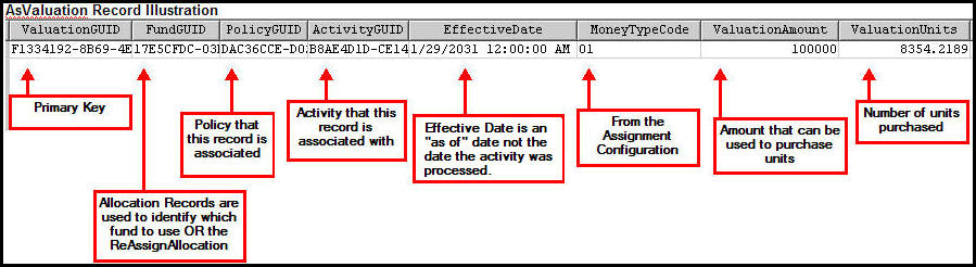

AsValuation Record Illustration
AsValuation record from database

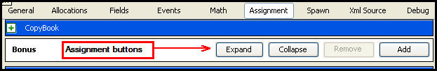

There are four buttons on the Assignment pane.
Assignment Pane Buttons
Assignment Pane and Assignment Buttons

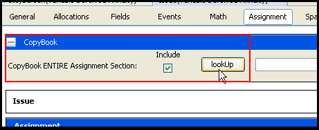

Insert Entire Assignment Section from CopyBook
  1. Navigate to the transaction and click the Assignment pane.
  2. Expand the CopyBook section at the top of the pane.
  3. Click the Include box.
  4. Click lookUp and select the CopyBook from the CopyBook Lookup window.
  5. Click OK. The CopyBook assignment information will be added to this pane.
CopyBook section expanded on Assignment pane
CopyBook Section on Assignment Pane

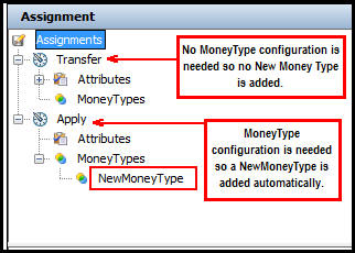

  4. Select Assignment icon Assignments
  5. Right-click and select Add or select the Add Add button button. A new assignment will be added with two nodes: attributes and money types.   If the assignment requires a money type configuration element, then it will be automatically added.
    Assignment Pane in Transaction Editor
    Assignment Pane of a Transaction with Two Types Added
