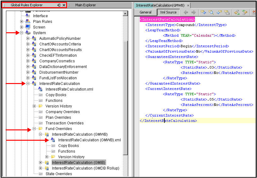

  1. Navigate to the Global Rules Explorer.
  2. Expand the Business Rule folder.
  3. Expand the System folder.
  4. Right-click on InterestRateCalculation.
  5. Select New InterestRateCalculation Override. The Override Wizard opens.
  6. Select the Next button for step one.
  7. Select the company, plan and fund where this override should be used.
  8. Select Finish.
  9. Configure your interest logic in the XML Source Pane of the override of the InterestRateCalculation that was created. View the V9 XML Configuration topic in this help system for additional information. View Business Rules | System Rules | InterestRateCalculation.
Interest Rate Calculation
InterestRateCalculation Rule in Global Explorer

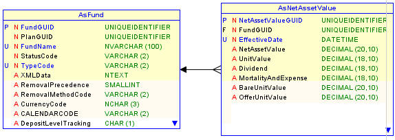

You can review the Funds data definitions to see how the Net Unit Values are associated.AsFund and AsNetAssetValues Tables
