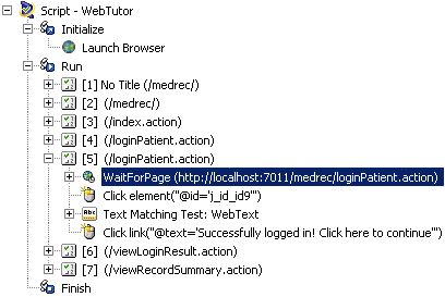

The Run node contains the navigations recorded to the script as Step Groups. By default, OpenScript Web Functional test scripts create Step Group nodes based on web page navigations. Step Group preferences can be changed in the OpenScript Preferences.
Expand the [5] (/loginPatient.action) Step Group and select the WaitForPage (http://systemName:7011/medrec/loginPatient.action) node as follows:
Figure 3-5 Script Tree with Expanded Step Group Node
The Step Group node shows the actions and parameters recorded for specific navigations and actions on a Web page.
The Details View tabs show the details for a specific navigation including a screen shot of the recorded page, the HTML source, and the browser rendering of the page.
Click the Screenshot, HTML, and Browser tabs to view the script details.
Expand the WaitForPage (http://systemName:7011/medrec/loginPatient.action) node. The script records Think time nodes to include the amount of user delay that occurred during recording as follows:
Select the Think node, click the right mouse button and select Properties. The Think time properties lets you edit the delay recorded to a script as follows:
Change the Think time value and click OK. This is useful if you want to reduce long a delay time that may have occurred during recording of script.
Right-click the Text Matching Test: Web Text node and select Properties. You can view or change the Text Matching test properties as follows:
Click Cancel to leave the Text Matching test properties unchanged.
Open and view the properties of other script nodes.

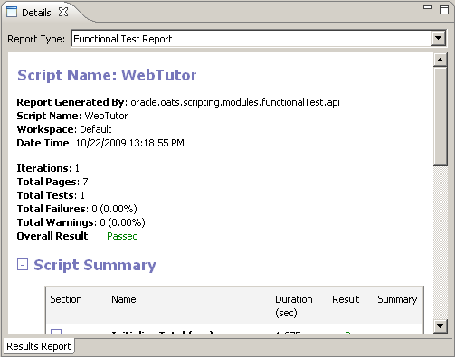

When playback finishes, expand the Results tree to view the results for each Step Group as follows:
Figure 3-9 Script Playback Results in the Results View
The "passed" results indicate that all referenced resources are available. Oracle OpenScript automatically generates a results report and opens the report in the Details view.
Select the top-level Result node or the script name in the Results view to view the results report in the Details view as follows:
Figure 3-10 Results Report in the Details View
Notice that all tests passed. This is because you played back the script using the same version of the Web pages that was used to record the script. This establishes a baseline of tests for the Web application or Web site's content and structure.

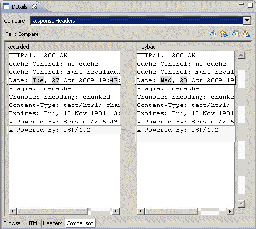

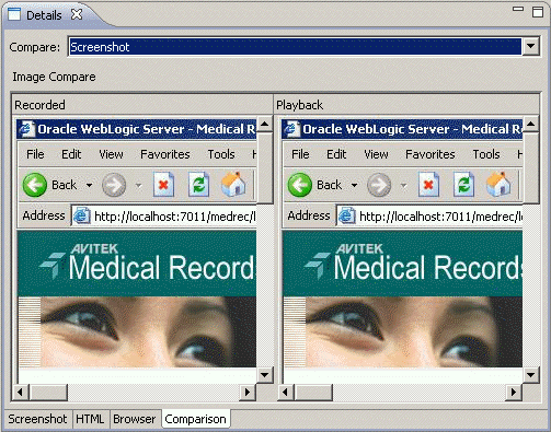

Click the Comparison tab in the Details view. The Comparison tab lets you compare the recorded HTML content, screenshots, and browser renderings of page navigations to the play back values as follows:
Figure 3-11 Details View Showing the Web Functional Test Comparison Tab
Select the Content and Browser options in the Compare list to compare the recorded and playback HTML source and browser renderings of the page.

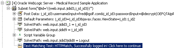

Expand the [4] Oracle WebLogic Server - Medical Record Sample Application script tree node.
Right-click the usernameInput parameter and select Substitute Variable. The Substitute Variable window opens with the databank field names listed as follows:
Select the Username field and click Finish. The parameter value changes to a databank variable in double braces{{db.avitek.Username,fred#@golf.com}} as follows:
Figure 3-19 Script Parameter with a Mapped Databank Variable
Right-click the passwordInput parameter and select Substitute Variable. The Substitute Variable window opens with the databank field names listed.
Select the Password field and click Finish. The parameter value changes to a databank variable in double braces{{db.avitek.Password,weblogic}} as follows:
Figure 3-20 Script Parameters with Multiple Mapped Databank Variables
Save the script.
Now we want to insert a Text Matching text case that verifies that the login results were successful.
Select the http://localhost:7011/medrec/loginPatient.action node under the [4] Oracle WebLogic Server - Medical Record Sample Application script tree node. The page appears in the Details view.
Select Add from the Script menu then select Other.
Select Text Matching Test in the HTTP Tests folder and click OK.
Enter HTTPMatch as the test name.
Enter Successfully logged in! Click here to continue as the Text to Match.
Make sure the Source options is HTML Display Contents.
Make sure the Pass When option is Pass if Present.
Make sure the Match option is Exact.
Click OK. The Text Matching test node appears in the script tree at the end of the Step Group as follows:
Figure 3-21 Script Tree with a Text Matching Test Node

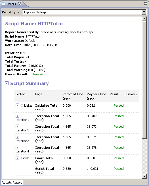

Watch the Details view as the script plays back the script several times using a different data value for the login each time.
View the playback results in the Results view. At the end of playback the Details view shows the results report similar to the following:
Figure 3-23 Results Report for Multiple Iterations
Scroll the Results view and select one of the HTTP navigation nodes such as Get window[@index='0'] http://systemName:7011/medrec/index.action.
Click the Comparison tab in the Details view. The Comparison tab for HTTP scripts lets you compare the recorded HTML content, Request Headers, Response Headers, and Cookies to the playback values as follows:
Figure 3-24 Details View Showing the HTTP Test Comparison Tab
