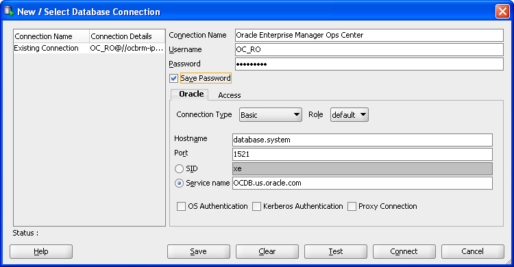

You must create a connection to the Oracle Enterprise Manager Ops Center database in Oracle SQL Developer.
In Oracle SQL Developer, click the New Connection icon in the Connections tab.
Enter the connection information, then click Save:
Connection Name: Enter a name for the connection. This name is only used in Oracle SQL Developer.
Username: Enter the schema name for the read only user.
Password: Enter the password for the read only user.
Hostname: Enter the database host name.
Port: Enter the Oracle*Net Listener port number.
Service Name: Select the service name option and enter the service name. For embedded databases, the service name is OCDB.us.oracle.com. For customer-managed databases, the service name is included in the mgmtdb.dburl property in the /var/opt/sun/xvm/db.properties file.

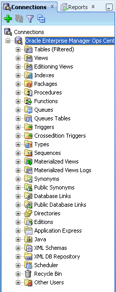

Once you have created a connection to the Oracle Enterprise Manager Ops Center database, you can view product data.
Select the connection you created in the previous procedure.
The contents of the target database are displayed.

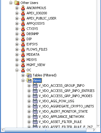

Within the database hierarchy, expand the Other Users section, then select the application user and expand the Views section. If you are using an embedded database, the application user is OC. If you are using a customer-managed database, the application user is included in the mgmtdb.appuser property of the /var/opt/sun/xvm/db.properties file.
The database columns visible to the application user are displayed.
View the comment column to find the location of the javadoc for each column. This javadoc explains the usage of the column.
