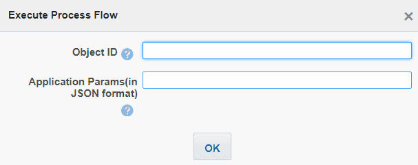

2. Click Test Process Flow. The Execute Process Flow window is displayed.
3. Enter an Object ID to identify the Process flow. This will be displayed as Entity ID in the Process Monitor window.
4. Enter the Application Parameters which are required in the Process flow that you are testing. Specify parameters in JSON format. This is an optional field.
For example, {"WF_RUNSK":"15","WF_MISDATE":"12/31/1999"}
5. Click OK.
