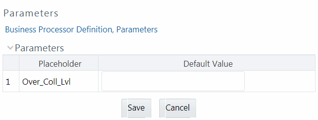

§ Click Parameters to specify default values for any of the placeholders defined.
The Parameters window is displayed.
i. Enter a default value for the place holders defined along with the expression in the Default Value field.
ii. Click Save to save the default value for a Place Holder.
