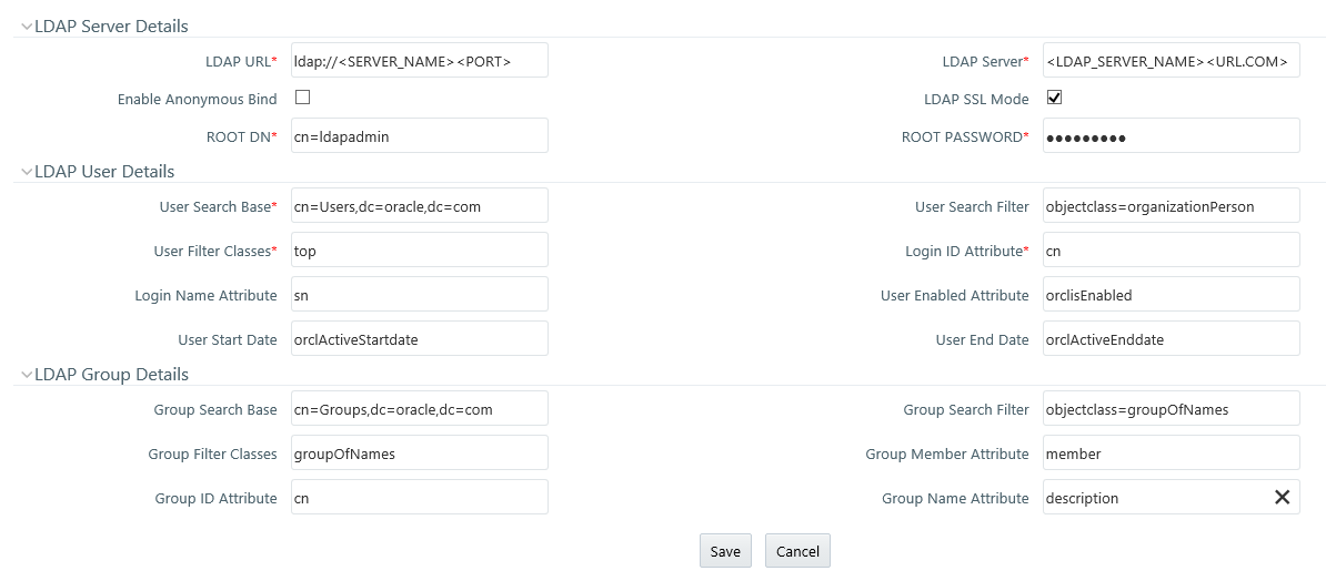

LDAP Server Details
This feature allows you to configure and maintain multiple LDAP servers in the OFSAA instance. You can add a new LDAP server, modify/ view LDAP server details, and delete an existing LDAP server.
The LDAP Server Details window displays the details such as ROOT Context, ROOT DN, LDAP URL, LDAP SSL Mode, and LDAP Server name.
To add a new LDAP Server
1.      Select LDAP Authentication & SMS Authorization from the Authentication Type drop-down list in the General Details tab, the LDAP Server Details window is displayed.
2.     Click  button in the toolbar. The LDAP Server Details window is displayed.
3.     Enter the details as tabulated:
Field
Description
Fields market with * are mandatory.
LDAP Server Details
LDAP URL
Enter the LDAP URL from which the system authenticates the user.
For example, ldap://hostname:3060/.
LDAP Server
Enter the LDAP Server name.
For example, ORCL1.in.oracle.com.
Enable Anonymous Bind
Select this option to login to the database anonymously and perform functions. This is useful when you are searching for a user in the system and cannot find the user. For example, you cannot find a cn due to a name change and you have to map the user to the correct dn. You can use a property such as email to search for the dn and map it correctly.
Note: Selecting this field disables ROOT DN and ROOT Password fields.
LDAP SSL Mode
Select the checkbox to enable LDAP over SSL to ensure encryption of user credentials when transferred over a network.
ROOT DN
Enter the ROOT Distinguished Name.
For example, cn=orcladmin,cn=Users,dc=oracle,dc=com.
ROOT Password
Enter the LDAP server root password for authentication.
LDAP User Details
User Search Base
Enter the full path of the location of the active directory in the LDAP server from which to start the user search. This is a comma-delimited parameter. For example, cn=User,dc=oracle,dc=com
User Search Filter
Enter search filters to limit the user search for the results obtained from ‘User Search Base’. For example, objectclass=organizationalPerson.
User Filter Classes
Enter a user search filter to include specific user groups. For example, enter ‘top’ for the search to access groups up to the top-level in the directory.
Login ID Attribute
Specify the login ID attribute (user name) to be used in the system for users. For example, enter ‘cn’ to use the common name as the login id attribute.
Login Name Attribute
Specify the attribute that maps to the Login ID. This is used for authentication purposes. For example, ‘sn’ maps to ‘cn’.
User Enabled Attribute
Enter the attribute to enable or disable a user. For example, ‘orclisEnabled’ is to enable a user account in the LDAP server.
User Start Date
Enter the attribute that stores the user-account start-date information. For example, ‘orcActiveStartdate’ contains start dates of all users.
User End Date
Enter the attribute that stores the user-account end-date information. For example, ‘orclActiveEndDate’ contains start dates of all users.
LDAP Group Details
Group Search Base
Enter the full path of the location of the active directory in the LDAP server from which to start the group search. This is a comma-delimited parameter. For example, cn=Groups,dc=oracle,dc=com
Group Search Filter
Enter search filters to limit the group search for the results obtained from ‘Group Search Base’. For example, objectclass=groupOfNames.
Group Filter Classes
Enter a group search filter to include specific groups. For example, groupOfNames.
Group Member Attribute
Enter a member attribute listed for the Groups. For example, ‘member’.
Group ID Attribute
Enter the attribute that identifies the group name. For example, ‘cn’.
Group Name Attribute
Enter the attribute that specifies the full name of the group. For example, description
4.    Click Save.

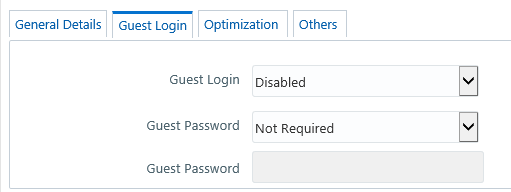

Update Guest Login Details
You (System Administrator) can facilitate Guest Users to login to the Infrastructure system by configuring the Guest Login Details. If a password is defined, then the guest users are required to enter the password during logon and would then be navigated to the specific modules based on the mapped Roles and Functions.
Ensure the following before configuring the guest user details:
·       Functions and Roles should be mapped appropriately for tracking the guest user activities on the system.
For example, when a guest user is permitted to modify Metadata, the change done cannot be tracked since the system recognizes Guest User as Modifier.
·       When there is a provision for Guest User to access the Infrastructure system from an external machine, a specific set of .jsp’s (web pages) has to be defined to the Guest User and maintained in the “urllist.cfg” in ficweb/conf folder.
For example, if the “urllist.cfg” contains “ficportal/Testing.jsp” and “fiv/OpenView.jsp’s”, Guest users can view and execute Testing and OpenView.jsp’s from ficportal and fiv contexts.
§       Any number of pages can be defined within the “urllist.cfg” file
§       The additions into the CFG file will be done manually.
§       Only the links specified in the urllist.cfg file can be accessed through the guest login.
·       You can also specify access based on wild card entries. A wildcard character can be applied at the main folder level only and not to a subset of files within a folder.
For example, if access is provided to ficportal/testing/*, then all the pages under ficportal/testing folder are accessible from Guest login.
1.      Select Guest Login tab and update the details as tabulated:
Field
Description
Guest Login
Select one of the following option from the drop-down list:
ENABLED - To enable guest users and allow them to login to the system.
DISABLED - To restrict access to guest users.
Guest Password
You can select the Guest Password as one of the following from the drop-down list only if you have ENABLED guest Login:
Required - Guest users need to specify a password to logon.
Not Required - Guest users can logon directly.
Guest Password
You can specify the Guest Password only if you have selected the previous Guest Password field option as Required.
Enter the Guest Password as indicated:
·       If Password Restrictions is set in the General Details tab, the specified password must satisfy all the defined parameters. However Guest Users do not comply to change password, invalid login attempts, or logging from multiple workstations,
·       If no Password Restrictions is set, ensure that the specified password is alphanumeric without any extra spaces.
2.     Click Save and save the guest login configuration details.

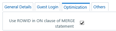

Update Optimization Details
1.      Select Optimization Details tab and update the details as tabulated:
The Optimization details such as Hints, Scripts, and Using ROWID instead of Primary Keys can be specified to optimize Merge statements. The defined configurations are also fetched as Query Optimization Settings while defining Rule definition properties.
Field
Description
Hint used for MERGE statement
Specify the SQL Hint that can be used to optimize Merge Query.
For example, “/*+ ALL_ROWS */”
In a Rule Execution, Merge Query formed using definition level Merge Hint precede over the Global Merge Hint Parameters defined here. In case the definition level Merge Hint is empty / null, Global Merge Hint (if defined here) is included in the query.
Hint used for SELECT statement
Specify the SQL Hint that can be used to optimize Merge Query by selecting the specified query.
For example, “SELECT /*+ IS_PARALLEL */”
In a Rule Execution, Merge Query formed using definition level Select Hint precede over the Global Select Hint Parameters defined here. In case the definition level Select Hint is empty / null, Global Select Hint (if defined here) is included in the query.
Script executed before MERGE statement
Refers to a set of semicolon (;) separated statements which are to be executed before Merge Query on the same connection object.
In a Rule Execution, Global Pre Script Parameters defined here are added to a Batch followed by Rule definition level Pre Script statements if the same has been provided during rule definition. However, it is not mandatory to have a Pre Script either at Global or definition level.
Script executed after MERGE statement
Refers to a set of semicolon (;) separated statements which are to be executed after Merge Query on the same connection object.
In a Rule Execution, Global Post Script Parameters defined here are added to a Batch followed by Rule definition level Post Script statements if the same has been provided during rule definition. However, it is not mandatory to have a Post Script either at Global or definition level.
User ROWID in ON clause of MERGE statement
You can select the ROWID checkbox to create a Merge Statement based on specified ROWID instead of Primary Keys.
In a Rule Execution, ROWID is considered while creating Merge Statement if Use ROWID checkbox is selected in either Global Parameters defined here or Rule definition properties.
If Use ROWID checkbox is not selected in either Global Parameters defined here or Rule definition properties, then the flag is set to “N” and Primary Keys are considered while creating in Merge Statements.
2.     Click Save and save the Optimization details.
