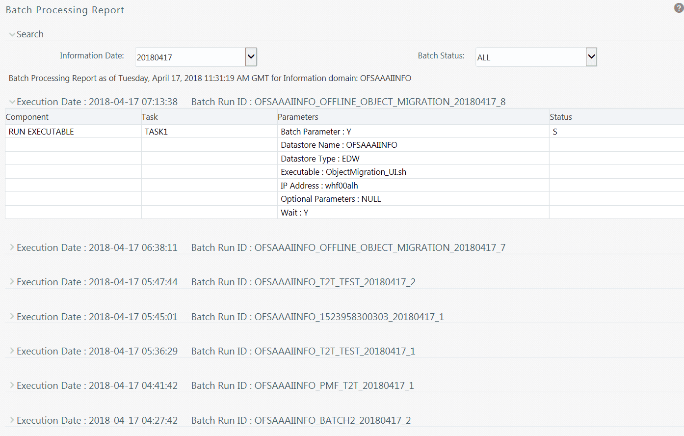

Batch Processing Report in the Infrastructure system facilitates you to view the execution status of each task component defined in a Batch. The Batch Processing Report window displays the Batch execution details such as Component, Task, Parameters, and Status. By default, the details of the Latest Batch Run are displayed.

To view the status of the required Batch, in the Batch Processing Report window:
1.      Select the Information Date from the drop-down list. The list consists of executed Batch Information dates in the descending order with the latest Batch Run details being displayed at the top.
2.     Select the required Batch Status from the drop-down list. The available batch statuses are:
§       ALL
§       Not Started
§       Ongoing
§       Complete
§       Failed
§       Cancelled
The window is refreshed and displays the status of each executed component of the selected Batch with the Task ID, defined Parameters, and the Status.
