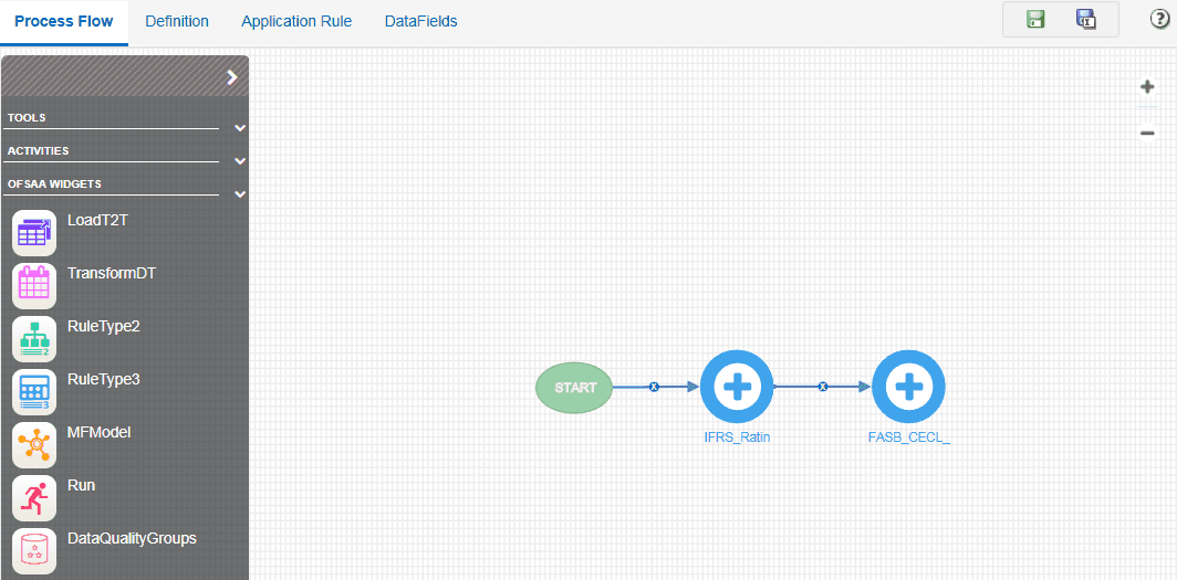

An Example of Inline Process
Click
icon. It opens up the process flow diagram of the IFRS_Rating_Classification_Proc as shown:

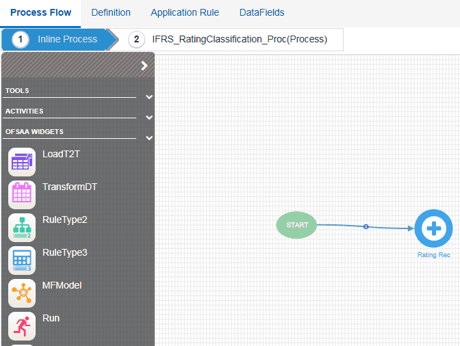

In this example, IFRS_Rating_Classification_Proc Inline Process has an Inline Process named Rating Reclassification. Double-clicking
opens up its process flow as shown:
Multiple levels of the Inline Process is supported. You can go to any level by clicking the Inline Process name displayed in the header. Click
to go to the parent process flow.
