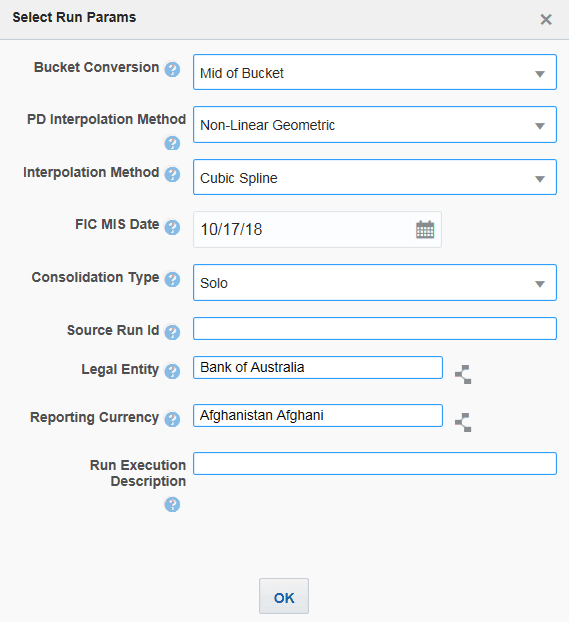

2. Click Execute Run to execute the Run Pipeline. The Select Run Params window is displayed.
3. Select values for the Run Parameters and click OK.
The execution of the Run Pipeline is triggered using the selected FIC MIS DATE. The RUNSKEY is generated and inserted into the “DIM_RUN” table. For the RUNSKEY generated, the corresponding user-selected parameters are inserted into the “RUN_EXE_PARAMETERS” table.
