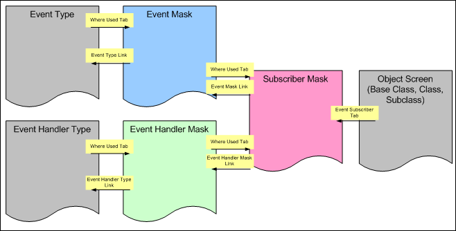

29.2.2 Event Subscription Components are Interconnected
This schematic depicts the connections between individual objects that are created in Event Management nodes.
For example, when you open an event type from the Event Types node, it has a Where Used tab that lists all event masks that use that event type. In the other direction, when you open an event mask from Events node, the field "Event Type" is a live link to the named event type object.
The right-most element "Object Screen" represents any object type—each row in Classes node—and each and every object type has an Event Subscribers tab that lists all event subscribers that are associated to this object type (because a given subscriber names an event mask that names the object type).
For Event-based Notifications, a Notification mask is the Handler. The distinction between Handler mask and Notification mask is simply because they are created in different nodes in Administrator, namely, Events Handlers node and Notifications node.
Figure 29-2 Connections between individual objects in Event Management nodes
Connections between individual objects in nodes

29.5 Working in Events Node
The Events node is where you create and manage Event masks.
29.5.1 Attributes of Event Masks
The table below lists attributes found on the General Information tab in Event masks.
All Event masks must name an Event Type. Most Event masks must name an Object Type (excepting those that name one of the "Global" event types).
System-generated names are a helpful feature when creating Event masks and Subscriber masks. The Name Helper button can be used: it concatenates Event Type and Object Type (if you select them before you manually enter a Name) to generate a Name and API Name.
Additional attributes may appear in the Create dialog as certain event types and object types are selected; these are given general mention in this table. "Additional attributes" are also noted by event type in "More about Selected Event Types."
The Where Used tab lists all Subscriber masks that use the Event mask.
