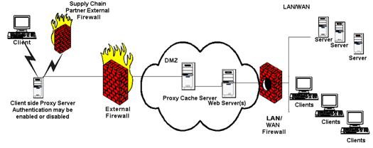

7.1.3 Typical Network Configurations
The figure below depicts a typical network configuration. The right side of the figure shows the internal LAN/WAN environment protected by a firewall. Then you have a DMZ area where web servers and a proxy cache or server-side proxy server exist. An additional firewall protects the DMZ from the Internet and other company environments. The proxy cache server is typically placed in front of the web servers and provides caching activities to improve performance for the clients behind the LAN/WAN firewall. The client in this case is beyond another corporate firewall and may have a client-side proxy server functioning as part of the firewall. A client-side proxy server brokers communication between the Internet and client browsers behind the firewall, protecting the clients from direct communication and possible threats. Client-side proxy software may require authentication, often username and password verification, before completing any requested transactions. Additionally, client-side proxy software may be configured as a transparent or a non-transparent proxy.
Figure 7-1 Typical Network Configuration
Surrounding text describes Figure 7-1 .
The initial installation of the Java client requires the transfer of a JAR file. Proxy configurations need to be considered when deploying the Java client to supply chain partners.

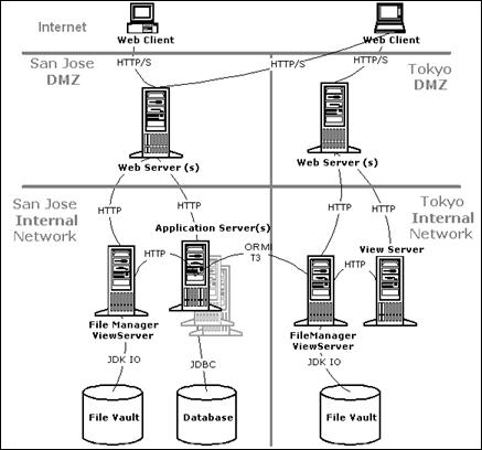

7.1.6 Distributed File Management
As the figure below depicts, a distributed file management server fits into the system configuration much like the application server. In fact, it is a local application server with only file operation capabilities. All users connect to the main application server through the proxy web servers, but when a remote user requests a file, they are pointed to their configured distributed file manager. A distributed proxy web server can be deployed in proxy calls between users and the file manager.
An Agile distributed file manager may connect to the Agile Application Server or another file manager if a request file does not exist in the local vault. The file manager connects to the Agile Application Server for other file operations such as deleting and redlining performed through AutoVue for Agile PLM. File manager to file manager communication occurs over application specific protocols and configured ports.
With remote centers, all attachment viewing, opening, and updating of documents is accomplished locally within the remote center. The only time a file attachment is transferred across the WAN is if the file version resides on another remote file server. At that time, the file is copied down to the local file server and then remains local when accessed again.
