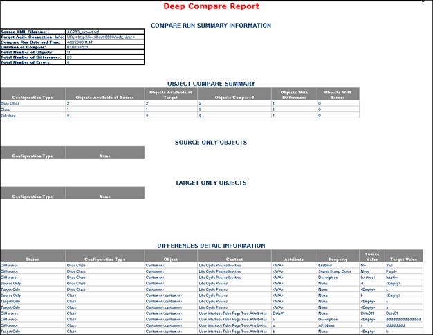

D.8.2.3 Deep Compare Difference Report
The Deep Compare Difference Report contains many fields of information. Following the screenshot of a typical report, a table lists all the fields and what information they convey.
There is a valid condition in Java Client criteria in which the Value field is null (is not populated with a value); ACP will report this as "Invalid Criteria Condition: Invalid value specified." You may ignore this error message.
Figure D-1 Sample Output of Deep Compare Report
Surrounding text describes Figure D-1 .

D.8.2.4 Deep Compare Report Sections and Fields
Deep Compare Report Sections and Fields Explanation
COMPARE RUN SUMMARY INFORMATION
High-level and summary information.
Source XML Filename Name of the Source ( .agl ) file used for Deep Compare, for example, ACP93_export.agl
Target Agile Connection Info This information will talk about the URL or Target instance being used for comparison purpose. This field also tells who (User ID) has compared the instances.
For example, URL = http://chandrakantdesk:8888/web; User = admin
Compare Run Date and Time Date and Time of Deep Compare report being generated, for example, 3/11/2009 2:34:24 PM
Duration of Compare How much time does ACP consume to compare the SOURCE and TARGET instances?
For example, 00:00:01:5.907
Total Number of Objects Compared How many objects have been compared?
This gives the total number of SOURCE objects being mapped or matched exactly with TARGET objects (including RENAME mapping if it is enabled).
Total Number of Objects Compared =∑ Objects Compared (OBJECT COMPARE SUMMARY) of all configurations, for example, 12.
Total Number of Differences How many differences found?
Total number of Differences is calculated based on the attribute level comparison after considering RENAME MAP, SUBOBJECTMAP and IgnoreRef (if you have enabled them in the Control file).
Total Number of Differences =∑ Objects With Differences (OBJECT COMPARE SUMMARY) of all configurations, for example, 120.
Total Number of Errors How many Objects are failed in this comparison?
Total Number of Errors =∑ Objects With Errors (OBJECT COMPARE SUMMARY) of all configurations + Processing errors, for example, 11.
Statistics of the configuration level.
Configuration Type Type of Configurations being compared. Refer enabled Configurations List for Deep Compare, for example, Company Profile.
Objects Available At Source Total number of Objects available at Source. This is based on pattern matching at control file (config.xml), for example, 110.
Objects Available At Target Total number of Objects available at Target. This is based on pattern matching at control file (config.xml), for example, 110.
Objects Compared How many objects have been compared in this configuration?
This gives the total number of SOURCE objects being mapped or matched exactly with TARGET objects (including RENAME mapping if it is enabled), for example, 34.
Objects With Differences How many differences found in this configuration?
Total number of Differences is calculated based on the attribute level comparison after considering RENAME MAP, SUBOBJECTMAP and IgnoreRef (if you have enabled them in the Control file), for example, 23.
Objects With Errors How many Objects are failed in this configuration?
Total number of objects failed to compare, for example, 02.
SOURCE ONLY OBJECTS
"Source only" objects: not found on Target instance. This is based on pattern matching at control file (config.xml).
Configuration Type Type of Configuration being compared. Refer to enabled Configurations List for Deep Compare, for example, Class.
Name Name of the Object, for example, ECO.
TARGET ONLY OBJECTS
"Source only" objects: not found on Source instance. This is based on pattern matching at control file (config.xml)
Name Name of the Object, for example,ECO1.
DIFFERENCES DETAIL INFORMATION
Detailed information about attribute values.
Status Status can be Difference, Source Only, Target Only(Do not confuse with above Source Only and Target only, this difference is at attribute level),Not Comparable, and so on.
This field also talks about Rename Map, Sub Object Map and Ignore References if it is enabled and matched at the both instances, for example, Difference.
Configuration Type Type of Configuration being compared. Refer to enabled Configurations List for Deep Compare, for example, Subclass.
Object Name of the Object, for example, ECO.
Context If Configurations are having UI Tabs and differences are existed in those Tabs, then details of accessing path will be given, for example, General Information.
Attribute Name of the Attribute, for example, Date01.
Property Name of the property, for example, Description.
Source Value Physical value at source instance, for example, ABC.
Target Value Physical value at target instance, for example, XYZ.
