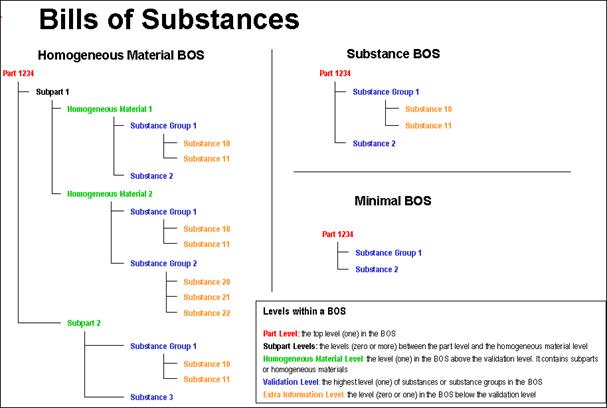

The Bill Of Substances is a hierarchical list of substances that are contained in the parts and assemblies that make up a BOM. This is a list of BOS hierarchical levels from any composition of a part or part group or subassembly or TLA:
Levels of the BOS
First or top level: the Composition of a part or assembly
Second level: Subpart
Third level: Homogeneous Material
Fourth level: Substance Group
Fifth level: Substance
You may recognize the 2nd-5th levels are the Substances classes. This order of this hierarchy is particularly important in compliance rollups, which are documented in "Rolling Up Compliance Data Using Internal Rollup." Note that the top level of a BOS is the Composition.

This creates a tree structure called the Bill of Substances. Suppliers need to provide information at each of the levels of the BOS.
Depending on the type of specification involved, levels in the above list may be omitted.
The rules relating to the type of substances that can be added to the Composition tab are:
A subpart can contain a material and a subpart at the same level. A subpart cannot contain all four types of substances at the same time.
A material can contain only substances and substance groups. A material cannot contain a subpart or a material.
Here are the valid structures of the Substances classes:
For Subparts:
Subpart > Substances AND/OR
Subpart > Substance Groups AND/OR
Subpart > Substance Groups > Substances
OR
Subpart > Homogeneous Materials AND/OR
Subpart > Subpart AND/OR
Subpart > Subpart > Homogeneous Material
For Homogeneous Materials:
Homogeneous Material > Substances AND/OR
Homogeneous Material > Substance Groups AND/OR
Homogeneous Material > Substance Groups > Substances.
