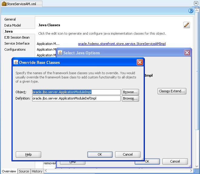

To create an ADF component based on a framework extension class:
In the Application Navigator, double-click the desired component.
In the overview editor, click the Java navigation tab and click the Edit Java options button.
In the Select Java Options dialog, click Classes Extends.
In the Override Base Classes dialog, enter the fully-qualified name of the framework base classes you wish to override. You can also use the Browse button to use the JDeveloper Class Browser to find the classes quickly.
When you use the Class Browser to select a custom base class for the component, the list of available classes is automatically filtered to show only classes that are appropriate. For example, when clicking Browse in Figure 37-2 to select an application module Object base class, the list will only show classes available in the current project's library list which extend the oracle.jbo.server.ApplicationModule class either directly or indirectly. If you don't see the class you're looking for, either you extended the incorrect base class or you have chosen the wrong component class name to override.

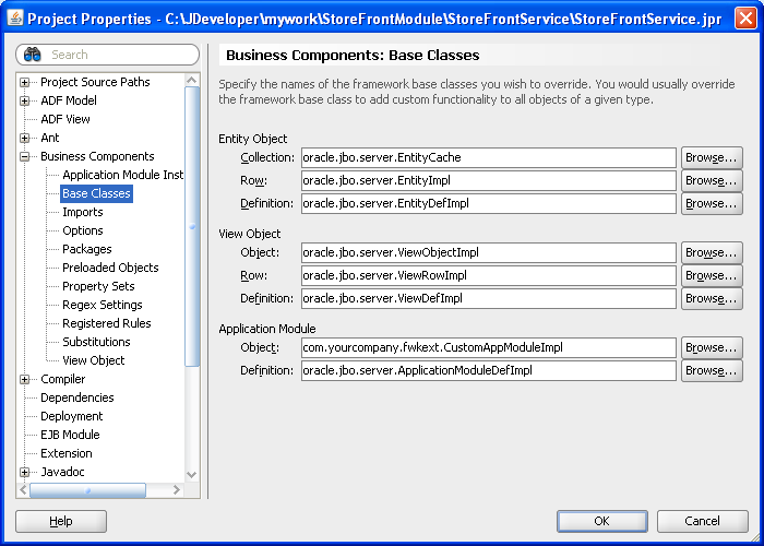

To define project-level preferences for framework extension classes:
In the Application Navigator, right-click the model project that will contain the extension classes and choose Project Properties.
In the Project Properties dialog, expand Business Components > Base Classes in the tree.
On the Business Components page, enter the fully-qualified name of that class in the Application Module Object class name field.
For example, to indicate that any new application modules created in the project should use the CustomAppModuleImpl class by default, enter the fully-qualified name of that class in the componentName Object class name field as shown in Figure 37-3.
When you want to apply the same base class preferences to each new project that you create in JDeveloper, you can define the preferences at a global level using the Preferences dialog. Base classes that you specify at the global level will not alter your existing projects containing ADF components.
To define global preferences for framework extension classes:
In the Tools menu, choose Preferences.
In the Preferences dialog, expand Business Components > Base Classes in the tree.
On the Business Components page, enter the fully-qualified name of that class in componentName Object class name field.
The page displays the same options for specifying the preferred base classes for each component type as shown in Figure 37-3.

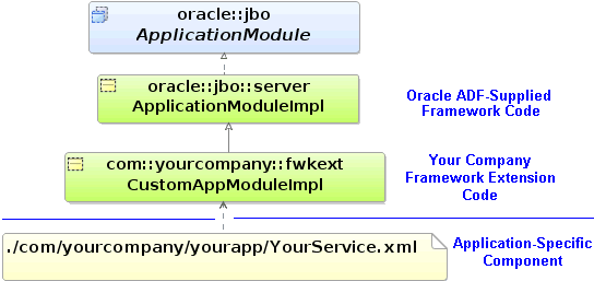

When an ADF component you create extends a custom framework extension class, JDeveloper updates its XML component definition to reflect the custom class name you've chosen.
For example, assume you've created the YourService application module in the com.yourcompany.yourapp package, with a custom application module base class of CustomAppModuleImpl. If you have opted to leave the component as an XML-only component with no custom Java file, its XML component definition (YourService.xml) will look like what you see in Example 37-2. The value of the ComponentClass attribute of the AppModule tag is read at runtime to identify the Java class to use to represent the component.
Example 37-2 Custom Base Class Names Are Recorded in XML Component Definition
<AppModule Name="YourService" ComponentClass="com.yourcompany.fwkext.CustomAppModuleImpl" > <!-- etc. --> </AppModule>
Figure 37-4 illustrates how the XML-only YourService application module relates to your custom extension class. At runtime, it uses the CustomAppModuleImpl class which inherits its base behavior from the ApplicationModuleImpl class.

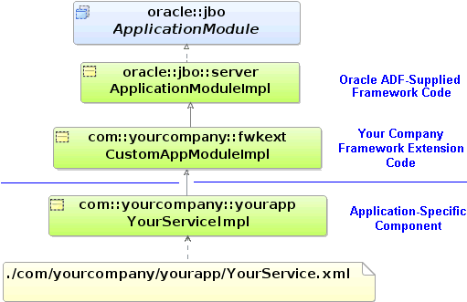

If your component requires a custom Java class, as you've seen in previous chapters you open the Java page of the component editor and check the appropriate checkbox to enable it. For example, when you enable a custom application module class for the YourServer application module, JDeveloper creates the appropriate YourServiceImpl.java class. As shown in Example 37-3, it also updates the component's XML component definition to reflect the name of the custom component class.
Example 37-3 Custom Component Class Recorded in XML Component Definition
<AppModule Name="YourService" ComponentClass="com.yourcompany.yourapp.YourServiceImpl" > <!-- etc. --> </AppModule>
JDeveloper also updates the component's custom Java class to modify its extends clause to reflect the new custom framework base class, as shown in Example 37-4.
Example 37-4 Component's Custom Java Class Updates to Reflect New Base Class

Figure 37-5 illustrates how the YourService application module with its custom YourServiceImpl class is related to your framework extension class. At runtime, it uses the YourServiceImpl class which inherits its base behavior from the CustomAppModuleImpl framework extension class which, in turn, extends the base ApplicationModuleImpl class.

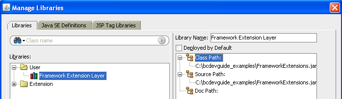

JDeveloper uses named libraries as a convenient way to organize the one or more JAR files that comprise reusable component libraries.
To define a library for your framework extensions JAR file:
Choose Tools > Manage Libraries from the JDeveloper main menu.
In the Manage Libraries dialog, select the Libraries tab.
Select the User folder in the tree and click the New button.
In the Create Library dialog that appears, name the library "Framework Extension Layer" and select the Class Path node and click Add Entry.
Use the Select Path Entry dialog that appears to select the FrameworkExtensions.jar file that contains the class files for the framework extension components, then click Select.
Select the Source Path node and click Add Entry.
Use the Select Path Entry dialog that appears to select the ..\FrameworkExtensions\src directory where the source files for the framework extension classes reside, then click Select.
Click OK to dismiss the Create Library dialog and define the new library.
When finished, you will see your new "Framework Extension Layer" user-defined library, as shown in Figure 37-6. You can then add this library to the library list of any project where you will be building business services, and your custom framework extension classes will be available to reference as the preferred component base classes.

In the overview editor, select the Java navigation tab and click the Edit Java options icon.
The Java Classes page should show an existing Java class for the application module identified as Application Module Class.
By default, JDeveloper generates the Java class for application modules you create. However, if you disabled this feature, click the Edit Java options button in the Java Classes section and select Generate Application Module Class. Click OK to add a Java class to the project from which you will create the custom interface.
In the Select Java Options dialog, click Class Extends.
In the Override Base Classes dialog, specify the name of the framework base class you want to override and click OK.
For example, you might select CustomApplicationModuleImpl as the base class for the application module.

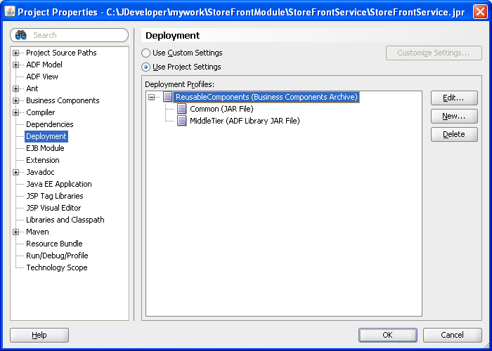

As with other Java components, you can create a JAR file containing one of more packages of reusable ADF components. Then, in other projects you can import one or more packages of components from this component library to reference those in a new application.
Use the Create Business Components Archive Profile dialog to create a JAR file containing the Java classes and XML component definitions that comprise your business components library. This is available in the New Gallery in the General > Deployment Profiles category.
If you don't see the Deployment Profiles category in the New Gallery, set the Filter By dropdown list at the top of the dialog to the All Technologies choice to make it visible.
Give the deployment profile a name like ReusableComponents and click OK. As the Project Properties dialog shows in Figure 37-8, the ReusableComponents business components deployment archive profile contains two nested JAR deployment profiles:
Common.deploy
MiddleTier.deploy
These two nested profiles are standard JAR deployment profiles that are pre-configured to bundle:
All of the business components custom java classes and XML component definitions into a ReusableComponentsCSMT.jar archive
All of the client interfaces, message bundle classes, and custom domains into a ReusableComponentsCSCommon.jar
They are partitioned this way in order to simplify deployment of ADF Business Components-based applications. The *CSMT.jar is an archive of components designed to be deployed only on the middle tier application server. The *CSCommon.jar is common both to the application server and to the remote client tier in the deployment scenario when the client interacting with the application module is running in a different physical server from the application module with which it is working.
To create the JAR files, in the Application Navigator right-click the Business Components project folder and choose Deploy and the ReusableComponents profile. A Deployment tab appears in the JDeveloper Log window that should display feedback like:
---- Deployment started. ---- Apr 28, 2009 7:04:02 PM Running dependency analysis... Wrote JAR file to ...\ReuseableComponents\deploy\ReuseableComponentsCSMT.jar Running dependency analysis... Wrote JAR file to ...\ReuseableComponents\deploy\ReuseableComponentsCSCommon.jar Elapsed time for deployment: less than one second ---- Deployment finished. ---- Apr 28, 2009 7:04:02 PM

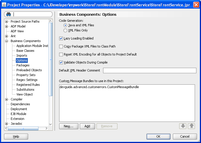

To create a custom message bundle file:
In the Application Navigator, right-click the model project that you want to add the message bundle file to and choose Project Properties.
In the Project Properties dialog, select Business Components > Options.
The Custom Message Bundles to use in this Project list displays at the bottom of the dialog.
Click New.
Enter a name and package for the custom message bundle in the Create MessageBundle class dialog and click OK.
If the fully-qualified name of your custom message bundle file does not appear in the Custom Message Bundles to use in this Project list, click the Remove button, then click the Add button to add the new message bundle file created. When the custom message bundle file is correctly registered, it's fully-qualified class name should appear in the list, as shown in Figure 37-9.
Click OK to dismiss the Project Properties dialog and open the new custom message bundle class in the source editor.
Edit the two-dimensional String array in the custom message bundle class to contain any customized messages you'd like to use.
Example 37-13 illustrates a custom message bundle class that overrides the error message string for the JBO-27014 error.

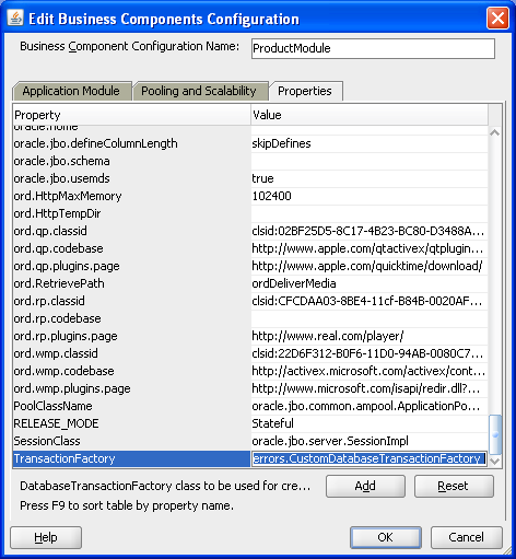

In order for your application module to use a custom database transaction class at runtime, you must:
Provide a custom implementation of the DatabaseTransactionFactory class that overrides the create() method to return an instance of the customized transaction class.
Configure the value of the TransactionFactory property to be the fully-qualified name of this custom transaction factory class.
Example 37-18 shows a custom database transaction factory class that does this. It returns a new instance of the CustomDBTransactionImpl class when the framework calls the create() method on the database transaction factory.
Example 37-18 Custom Database Transaction Factory Class
package devguide.advanced.customerrors;
import oracle.jbo.server.DBTransactionImpl2;
import oracle.jbo.server.DatabaseTransactionFactory;
public class CustomDatabaseTransactionFactory
       extends DatabaseTransactionFactory {
  public CustomDatabaseTransactionFactory() {
   * Return an instance of our custom ToyStoreDBTransactionImpl class
   * instead of the default implementation.
   * @return instance of custom CustomDBTransactionImpl implementation.
  public DBTransactionImpl2 create() {
    return new CustomDBTransactionImpl();
To complete the job, use the Properties tab of the Create Business Components Configuration dialog to assign the value devguide.advanced.customerrors.CustomDatabaseTransactionFactory to the TransactionFactory property, as shown in Figure 37-10. You can open the Create Business Components Configuration dialog from the Configuration page of the overview editor for the application module by clicking the Create new configuration objects button. When you run the application using this configuration, your custom transaction class will be used.

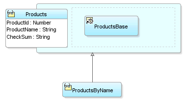

Whenever you create a new business component, if necessary, you can extend an existing one to create a customized version of the original. As shown in Figure 37-11, the ProductsByName view object extends the Products view object to add a named bind variable named TheStatus and to customize the WHERE clause to reference that bind variable.
While the figure shows a view object example, this component inheritance facility is available for all component types. When one component extends another, the extended component inherits all of the metadata and behavior from the parent it extends. In the extended component, you can add new features or customize existing features of its parent component both through metadata and Java code.
The example in this section refers to the BaseProject project of the AdvancedExamples workspace in the StandaloneExamples module of the Fusion Order Demo application.
To create an extended component, use the component wizard in the New Gallery for the type of component you want to create. For example, to create an extended view object, you use the Create View Object wizard. On the Name page of the wizard — in addition to specifying a name and a package for the new component — provide the fully-qualified name of the component that you want to extend in the Extends field. To pick the component name from a list, use the Browse button next to the Extends field. Then, continue to create the extended component in the normal way using the remaining panels of the wizard.
After you define an extended component, JDeveloper lets you change the parent component from which an extended component inherits. You can use the overview editor for the component to accomplish this.
To change the parent component after creation:
Double-click the component.
In the overview editor for the component, click the General navigation tab and click the Refactor object extends button next to the Extends field.
In the Select Parent dialog, choose the desired component to extend from the package list.
To change the extended component to not inherit from any parent, select the None checkbox in the Select Parent dialog. This has the same effect as if you deleted the component and recreated to accomplish this.
ADF business components you create are comprised of an XML component definition and an optional Java class. When you create a component that extends another, JDeveloper reflects this component inheritance in both the XML component definition and in any generated Java code for the extended component.
JDeveloper notes the name of the parent component in the new component's XML component definition by adding an Extends attribute to the root component element. Any new declarative features you add or any aspects of the parent component's definition you've overridden appear in the extended component's XML component definition. In contrast, metadata that is purely inherited from the parent component is not repeated for the extended component.

When you create an extended view object like ProductsByName, if that view object adds an addition attribute like SomeExtraAttr and has a custom view row class enabled, then its attribute constants will be computed relative to the maximum value of the attribute constants in the parent component:
public class ProductsByNameRowImpl extends ProductsRowImpl
                                   implements ProductsByNameRow {
  public static final int MAXATTRCONST =
    ViewDefImpl.getMaxAttrConst("devguide.advanced.baseproject.extsub.Products");
  public static final int SOMEEXTRAATTR = MAXATTRCONST;
Additional attributes would have index values of MAXATTRCONST+1, MAXATTRCONST+2, etc.

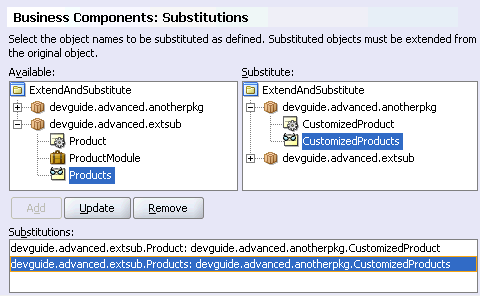

To define global component substitutions, use the Project Properties dialog in the project where you have created extended components based on the imported components from the base application.
You can only substitute a component in the base application with an extended component that inherits directly or indirectly from the base one.
To substitute an extended component:
In the Application Navigator, right-click the model project that you want to add the extended component to and choose Project Properties.
In the Project Properties dialog, select Business Components > Substitutions.
In the Substitutions page, select the base application's component in the Available list.
Select the customized, extended component to substitute in the Substitute list.
Click Add.
For example, assume that you have created the view object CustomizedProducts in a package that extends the base view object Products. To substitute the CustomizedProducts view object for the legacy Products view object, you would select these view objects as shown in Figure 37-12 to define the component substitution.
When you define a list of global component substitutions in a project named YourExtendsAndSubstitutesProject, the substitution list is saved in the YourExtendsAndSubstitutesProject.jpx in the root directory of the source path.
The file will contain Substitute elements as shown in Example 37-22, one for each component to be substituted.
