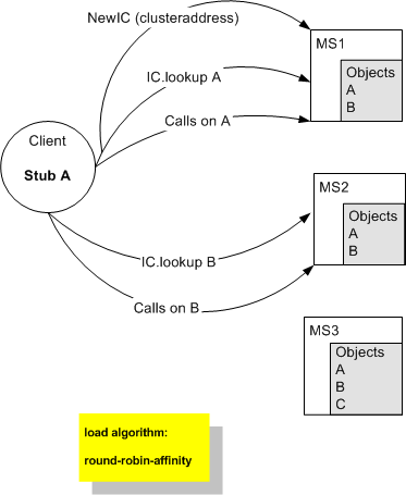

Example 1—Context From Cluster
In the example shown in Figure 5-1, the client obtains context from the cluster. Lookups on the context and object calls stick to a single connection. Requests for new initial context are load balanced on a round-robin basis.
Figure 5-1 Client Obtains Context From the Cluster
Client requests a new initial context from the cluster (Provider_URL=clusteraddress) and obtains the context from MS1.
Client does a lookup on the context for Object A. The lookup goes to MS1.
Client issues a call to Object A. The call goes to MS1, to which the client is already connected. Additional method calls to Object A stick to MS1.
Client requests a new initial context from the cluster (Provider_URL=clusteraddress) and obtains the context from MS2.
Client does a lookup on the context for Object B. The call goes to MS2, to which the client is already connected. Additional method calls to Object B stick to MS2.

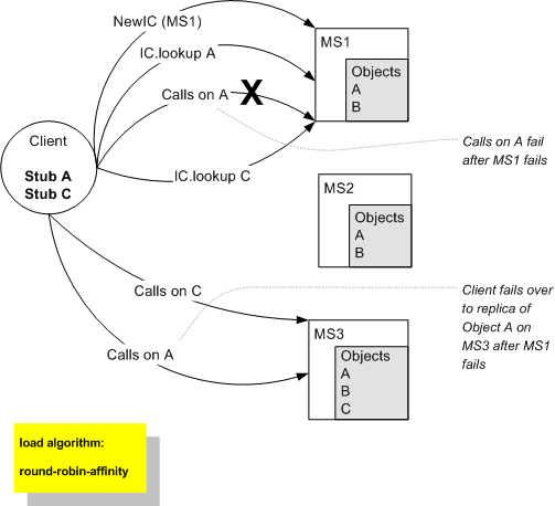

Example 2—Server Affinity and Failover
The example shown in Figure 5-2 illustrates the effect that server affinity has on object failover. When a Managed Server goes down, the client fails over to another Managed Server to which it has a connection.
Client requests new initial context from MS1.
Client makes a call to Object A. The call goes to MS1, to which the client is already connected. Additional calls to Object A stick to MS1.
The client obtains a stub for Object C, which is pinned to MS3. The client opens a connection to MS3.
MS1 fails.
Client makes a call to Object A.The client no longer has a connection to MS1. Because the client is connected to MS3, it fails over to a replica of Object A on MS3.

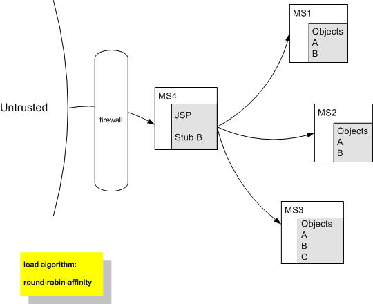

Example 3—Server affinity and server-to-server connections
The example shown in Figure 5-3 illustrates the fact that server affinity does not affect the connections between server instances.
Figure 5-3 Server Affinity and Server-to-Server Connections
A JSP on MS4 obtains a stub for Object B.
The JSP selects a replica on MS1. For each method call, the JSP cycles through the Managed Servers upon which Object B is available, on a round-robin basis.

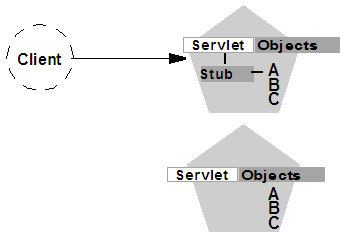

WebLogic Server does not always load balance an object's method calls. In most cases, it is more efficient to use a replica that is collocated with the stub itself, rather than using a replica that resides on a remote server. Figure 5-4 illustrates this.
Figure 5-4 Collocation Optimization Overrides Load Balancer Logic for Method Call
In this example, a client connects to a servlet hosted by the first WebLogic Server instance in the cluster. In response to client activity, the servlet obtains a replica-aware stub for Object A. Because a replica of Object A is also available on the same server instance, the object is said to be collocated with the client's stub.
WebLogic Server always uses the local, collocated copy of Object A, rather than distributing the client's calls to other replicas of Object A in the cluster. It is more efficient to use the local copy, because doing so avoids the network overhead of establishing peer connections to other servers in the cluster.

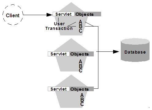

As an extension to the basic collocation strategy, WebLogic Server attempts to use collocated clustered objects that are enlisted as part of the same transaction. When a client creates a UserTransaction object, WebLogic Server attempts to use object replicas that are collocated with the transaction. This optimization is depicted in the example shown in Figure 5-5.
Figure 5-5 Collocation Optimization Extends to Other Objects in Transaction
In this example, a client attaches to the first WebLogic Server instance in the cluster and obtains a UserTransaction object. After beginning a new transaction, the client looks up Objects A and B to do the work of the transaction. In this situation WebLogic Server always attempts to use replicas of A and B that reside on the same server as the UserTransaction object, regardless of the load balancing strategies in the stubs for A and B.
This transactional collocation strategy is even more important than the basic optimization described in Optimization for Collocated Objects. If remote replicas of A and B were used, added network overhead would be incurred for the duration of the transaction, because the peer connections for A and B would be locked until the transaction committed. Furthermore, WebLogic Server would need to employ a multi-tiered JDBC connection to commit the transaction, incurring additional network overhead.
By using collocating clustered objects during a transaction, WebLogic Server reduces the network load for accessing the individual objects. The server also can make use of a single-tiered JDBC connection, rather than a multi-tiered connection, to do the work of the transaction.
