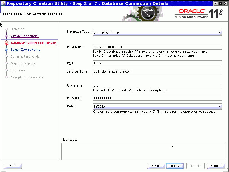

Go to $RCU_HOME/bin and execute the RCU utility.
Choose Create at the starting screen. Click Next.
The Database Connection Details page appears. Enter your database details:
Click Next.

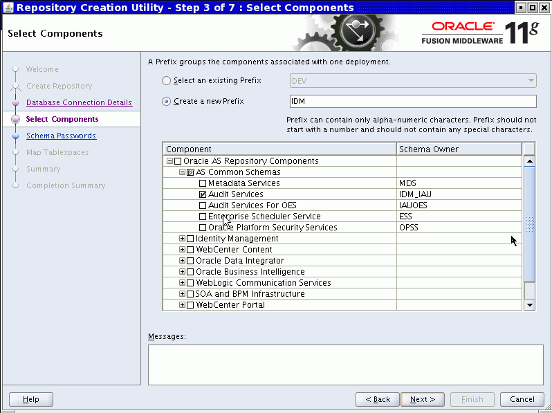

The Select Components page appears. Choose the option to create a new prefix, for example IDM. The prefix is applied to schema owner and tablespace names. Three schema users are created using this prefix; in the example, they are IDM_IAU, IDM_IAU_APPEND, and IDM_IAU_VIEWER.
Also, select 'Audit Services' from the list of schemas.
Click Next.

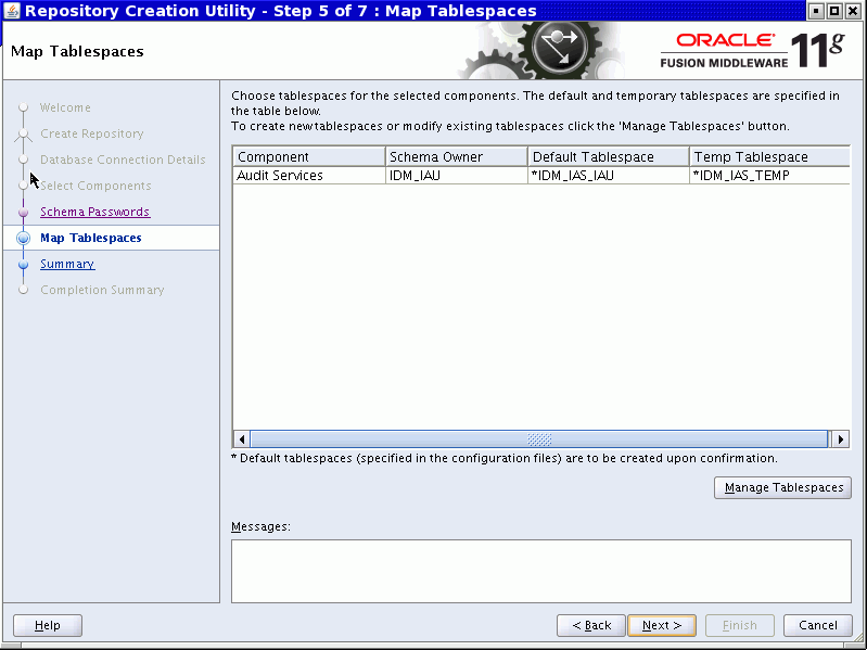

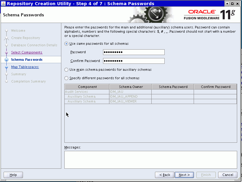

The Schema Passwords page appears.
Enter the password and click Next.
The Map Tablespaces page appears. Click Next and accept the tablespace creation.

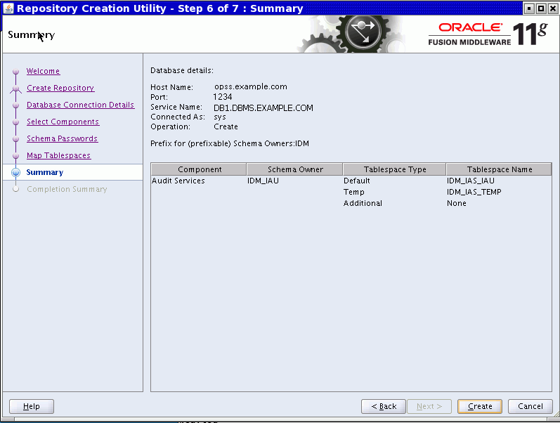

The Summary page appears.
Check the details and click Create.

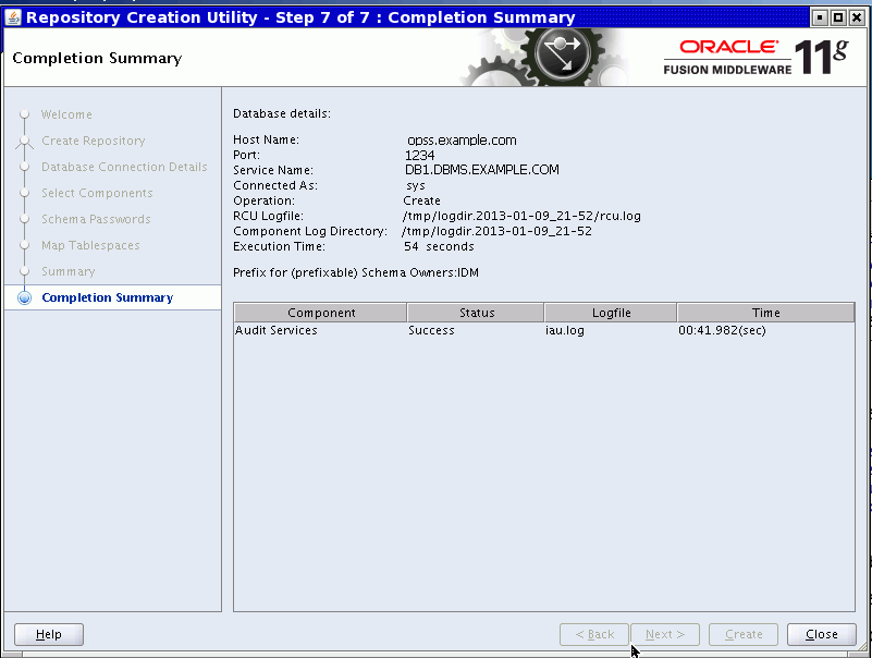

Check for any errors while the schemas are being created. Verify that the job is successful on the Completion Summary page:
This process will take several minutes to complete.

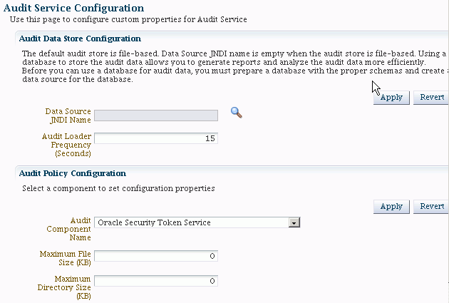

This task is performed with Oracle Enterprise Manager Fusion Middleware Control.

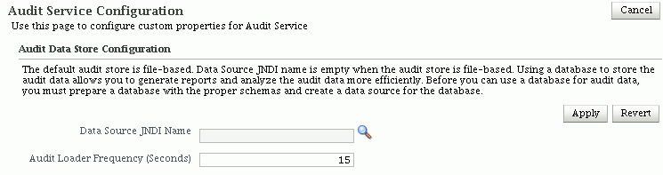

To view the current audit data store configuration:
Navigate to Domain, then Security Provider Configuration.
Under the Audit Service section, click Configure.
This page shows:
Datasource JNDI Name - If a database store is configured for audit records, this field shows the JNDI name of the datasource. The field is empty when the audit data store is not configured. By default a database is not configured, and audit records are stored in bus-stop files.
Audit Loader Frequency - This field shows the frequency, in seconds, at which data is moved from bus-stop files to the audit data store.
See Section 13.2.2, "Set Up Audit Data Sources" for datasource examples.
You can perform certain tasks related to audit store configuration:
Change from storing audit records in a file to using a database audit data store.
Configure bus-stop storage properties for a component's audit records.
Take these steps to configure these features:
Navigate to Domain, then Security, then Security Provider Configuration .
Click the Audit Service Configuration button. The Audit Service Configuration page appears.
To configure the audit data store:
Click the searchlight icon next to the Datasource JNDI Name field.
A dialog box appears showing the list of datasources available for audit records in the domain. Select the desired datasource and click OK.
The selected datasource is displayed in the Datasource JNDI Name field. Click Apply to continue, or Revert to abandon the update.
You can also use the WLST setAuditRepository() command to change the audit data store settings. See Appendix D, Fusion Middleware Audit Framework Reference for details.
Enter the audit loader frequency in seconds. The audit loader checks for and pushes records to the repository at the specified intervals.
Click Apply.

The size of a file for the file storage mode can be managed using the max.fileSize property described in the configuration file jps-config.xml. This property controls the maximum size of a bus-stop file for Java components.
Specify the sizes in bytes as described in Section 13.3.4, "Manage Audit Policies Manually".
System Components
The size of a file for the file storage mode can be set in the auditconfig.xml file. SeeSection 13.3.4.4, "Manually Configuring Audit for System Components".
If you switch from file to database store for audit data, all the events collected in the audit files are pushed into the database tables and the audit files are deleted.
Java Components
The size of a directory for the file can be managed using the max.DirSize property described in the configuration file jps-config.xml. This property controls the maximum size of a bus-stop directory.
System Components
The size of a directory for the file storage mode can be set in the auditconfig.xml file. See Section 13.3.4.4, "Manually Configuring Audit for System Components".

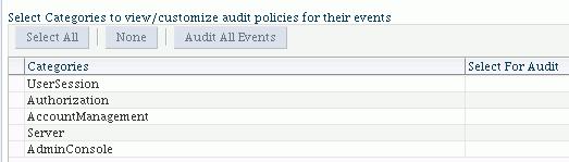

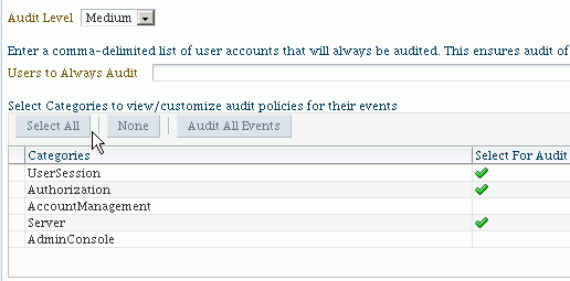

Use the Audit Component Name drop-down to select the Java component whose audit policy you wish to configure.
When you select a component, a table of audit categories relevant to the component appears in the area of the page titled Audit Policy Settings. The following example is for Oracle Access Manager:
Use the Audit Level drop-down to select a subset of the audit events for the component. The choices are:
None - No event categories selected.
Low, Medium, High - Subsets of event categories representing pre-defined levels of auditing.
Custom - Enables you to create or modify a custom filter definition.

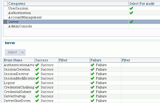

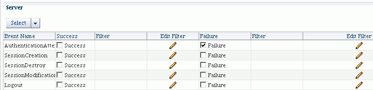

Depending on the level you select, check flags appear in the column Select for Audit. Events in the checked categories will be audited. For example, at the Medium level for Oracle Access Manager:
The flagged categories are selected for audit. You can view the events within a flagged category by clicking on that row in the categories table. For example, clicking on the Server category produces the following event table below it:
The table of events can only be edited in custom level. It cannot be edited at the pre-defined levels.

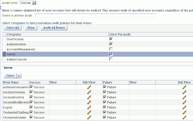

While the pre-defined levels are sufficient in many cases, you may wish to fine-tune the audit policy for the component.
To customize the audit policy, use the "Custom" option from the drop-down. This preserves the pre-defined categories but the green check-marks now appear as check-boxes, and all categories are available for selection:
You can select desired categories and events to fine-tune the audit policy. For example, you might wish to audit only failed authentication attempts in the Server category:

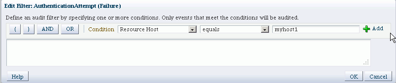

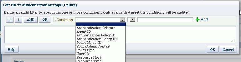

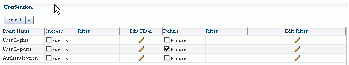

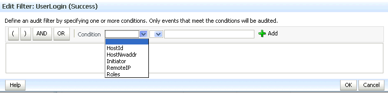

Filters are rule-based expressions that you can define to qualify or filter events for audit. The expressions are based on attributes of the event. For example, you may wish to further fine-tune the policy to narrow down the types of failed authentication attempts to audit.
A pencil icon in the Edit Filter column denotes that a filter is available for the event. Click on the icon to bring up the Edit Filter dialog:
Specify the filter using the condition boxes, which consist of the filter condition, an operator, and a value. After specifying each condition, click the add button. When finished adding conditions, click OK to save the changes.
In this example, a failed authentication attempt triggers an audit event only if the server hosting the protected application is named myhost1:
Each filter attribute has a formal name and a display name. You may see either name in the filter edit dialog. Display names are shown in the drop-down, while names are shown in the edit dialog. For example, if you select 'Client Address IP' in the drop-down box, it is renamed to 'RemoteIP' after you add it to the filter expression.

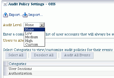

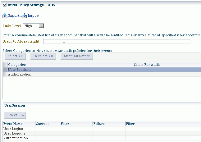

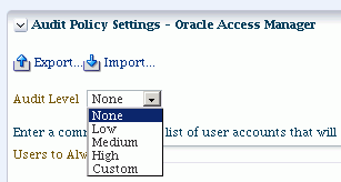

From the component menu, navigate to Security, then Audit Policy. The Audit Policy Settings page appears
You can select from a drop-down list of pre-configured audit levels. Three pre-defined levels (Low, Medium, High) will automatically pick up a subset of the audit events for the component.
The selection of events under the drop-down box cannot be edited for the pre-defined levels. It can only be edited in custom level.
None - No events are selected for audit.
Low - A small set of events is selected, typically those having the smallest impact on component performance.
Medium, High- This is a larger set of events. These events may have a higher impact on component performance.
Custom - This level enables you to fine-tune the policy, and is described in Step 5 below.
The table shows the events you can audit for the component instance. This example is for Oracle HTTP Server:

To customize the audit policy, use the "Custom" option from the drop-down. This allows you to select event categories by checking the relevant boxes under the "Select For Audit" column.
A second table lists the events in each category, enabling you to additionally filter for success and failure outcomes of each individual event to further control how they are audited, as explained in Step 6.
Filters are rule-based expressions that you can define to qualify or filter events for audit. The expressions are based on attributes of the event. For example, a Login type event could specify an initiator as a user filter in which case the event would generate an audit record whenever the specified user logged in.
A pencil icon indicates that a filter is available for the corresponding event.
Click on a pencil icon to bring up the Edit Filter dialog.
Click "Select Failures Only" to select only failed events in the policy - for example, a failed authentication. The Enable Audit box is now checked for failed events.
Import/Export - These buttons enable you to save and re-use a policy configuration. At any time while editing the policy, click Export to save the current settings to a file, and Import to load the settings from a saved file.
Optionally, under “Users to Always Audit”, a comma-separated list of users can be specified to force the audit framework to audit events initiated by these users; auditing occurs regardless of the audit level or filters that have been specified.

In this scenario, the domain's current policy audits user logout events. We would like to remove the logout events from the policy and instead, audit login events.
The following invocation of setAuditPolicy performs this task:
This example uses the component type OHS for Oracle HTTP Server. Substitute the relevant component type when using the command.
setAuditPolicy (filterPreset="Custom",addCustomEvents="OHS:UserLogin", removeCustomEvents="OHS:UserLogout")

The audit schema is created through the Repository Creation Utility (RCU). This section explains the organization of the audit schema and contains the following topics related to maintaining the schema:
See Also:
For more information on RCU, see Oracle Fusion Middleware Repository Creation Utility User's Guide.

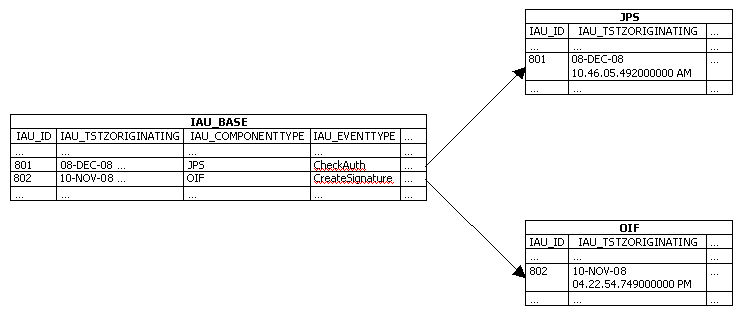

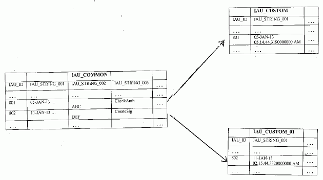

Common Table and Custom Tables
Figure 13-1 shows the data in the common table and how it relates to the custom tables.
Base Table and Component Tables
Figure 13-2 shows the data in the base table and how it relates to the component-specific tables.
